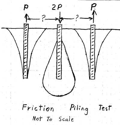

If the reaction piles are less than 5 diameters horizontally to the test pile, the tensions and compression stress overlap ("fans") becomes non-negligible.

I think it is to the benefit of the contractor to keep the reaction piles further from the test pile so that the stress bulb of the test pile and reaction piles will not overlap. In this way, the geotechnical capacity of the test pile will not be compromised by the reaction piles.
RE: Pile load test, ASTM vs BS
To be clear, the interaction between the reaction tension piles in close proximity to the center test pile produces an increased test load and decreased vertical displacement. Both theoretically and in practice. That is, reaction piles too close to the test pile gives unconservative results.

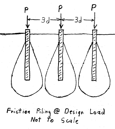

mbilal89 - I believe you can make a convincing proposal that the 5x diameter ASTM spacing can be considered for revision.
For friction piling, 3x spacing is often considered a reasonable minimum for a specified design load (P). Concept pressure distribution shown below:
Then, what spacing is reasonable for a friction pile load test at 200% of P? Concept pressure distribution:
A point-bearing load test concept pressure distribution looks reasonable, too:
A compromise answer may be > 3x, but could easily be < 5x.
