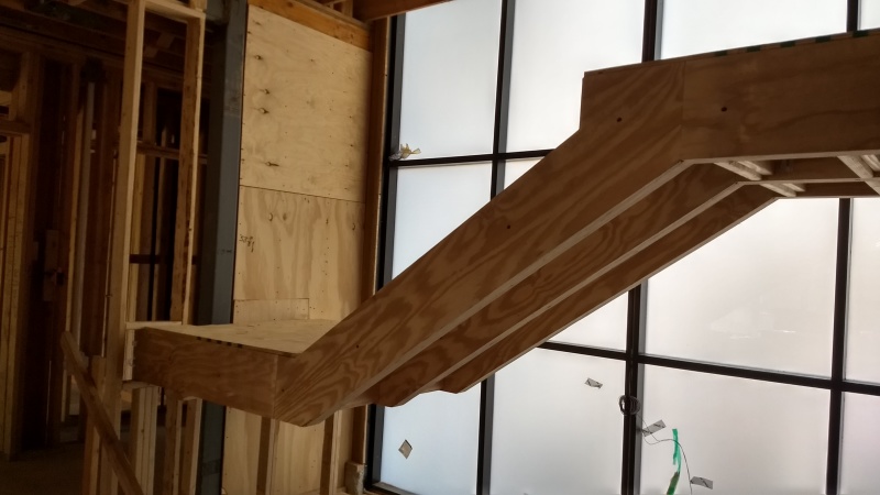

I have a question about a moment connection in a wood frame. Attached to this post is a sketch with an issue I'm dealing with. Could you please look at the sketch and tell me what do you think I should use to carry a moment at the stringer/joist connection? In addition to that, is there any way to reduce the deflection other than more material (sistering a stringer)? I have never designed a moment connection in wood so any help would be appreciated.
2x12 SPF#2
Thank you,

Can you post a floor plan of the stair area? Is there any reason why you can't frame the stair landing with typical floor joists? Typically your landing would have a double or triple floor joist at the stringer location to pick up the load from the stringer.
RE: Wood stairs moment connection
Moment connections are possible in wood but it's usually mass timber stuff with fancy hardware or dirt simple joist sistering exercises. In my opinion, a moment connection like this, involving a direction change and a reduced throat, is impractical. Especially so if you'r goal is the control of deflection/vibration. Whatever moment connection you come up with is likely to have a fair bit of give in it at the early stages of loading. If it's a repair, perhaps you could glue on some gusset plates and hope for a qualitative performance enhancement. If it's new construction, I'd try to find another way as shotzie has intimated.

It is not a repair. New stairs are being installed, and this is an architect concept. My idea was to install a beam at the top of the stairs and "hang" it to the ceiling with a 4x4 railing post.
Floor plan of the stair area is attached. There is nothing on the "left" site of stairs. There is a wall on the right side.

Agree with the posters above. Do not do this. Find another way. As Kootk indicated there will be some significant slip in the construction at the early stage, and then long term creep after that. Before long your landing will have a pretty significant slope to it.

Can you cantilever a new triple floor joist over the existing wall (on the right side of the stair) to pick up the stringer? Or install a new double/triple beam in the existing wall going up down at the bottom left corner of the landing that cantilevers out to allow for conventional floor joist framing for the landing? As the others have mentioned the proposed cranked wood frame likely won't work.

I'm afraid I can't cantilever the steps. The architect said he will send me calculations of their engineers who supposedly have done something like this several times. We will see, I will let you know. Thanks for all the advice!

With too many Archs. these days, nothing is impossible or too expensive when it comes to the edifice they are building to show their design talents; that is, as long as it is someone else’s responsibility to make it work without any problems and as long as they can blame that other party for the ridiculous extra costs and efforts involved in their perfect design. To often, they have no idea why it won’t work or isn’t a good idea, and they don’t seem to give a damn. They (or CAD) can draw it, so it must work. I would design cranked steel stringers spanning from the lower floor, up the steps plane to landing plane change and on to the LVL. Make the bot. flg. about 4" wide and centered on the web. Make the web shallow enough so as to miss/clear the tread/riser cuts on the 2x12's at the steps. Make the top flg. one sided, and thicker, like a channel flg. Have the fab’er. weld some threaded studs on the opp. side of the web (away from the top flg.) to fix the sistered 2x12 stringer framing to the steel. The wood stringers bear on the bot. stl. flg., with the bolts sistering them Install some wood blocking for stability. This is all done for Arch. sex appeal, at great expense. A few 4x4 posts with invisible paint would work better. smile
We asked for calcs for this stair 'z' wood stringer and never received any.
In my opinion, if you're thinking about having custom steel plates fabricated to create a connection that won't work well, you might as well go ahead and make the stringers with C shapes. Add clips to attach treads, if necessary, and/or holes so that wood can be easily attached to the steel. The whole thing can be wrapped and trimmed in wood. They can probably have one made for a few hundred $US, or whatever your commonly accepted local currency.

That looks like a pretty big steel column in the wall at the end of the stairs (in the pic from nac521).
Maybe there's a "yardarm" on there holding things up.
I've done similar things before.
