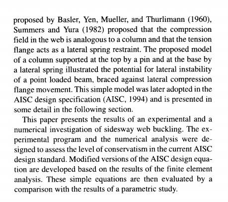

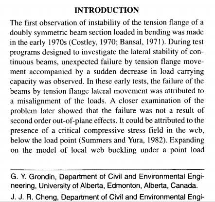

Google "Sidesway Web Buckling of Steel Beams" and some papers come up that discuss this.
RE: Steel Truss
Quote (jayrod)
Then the only thing left it the remaining web and tension flange buckling/twisting
Yup, I see what you're getting at. If top flange rotational restraint is given as a prerequisite to the problem then, certainly, the stiffness of the web and it's flange connections would come into play. Effectively, the restrained top flange reaches down via the web to laterally restrain the bottom flange which then restrains the bottoms of the compression webs.
This same mechanism can work in trusses too. Sometimes you'll have beams or secondary trusses tying into the girder truss webs with nominally capable moment connectins that will brace the girder bottom flange the same way. Basically AISC style rotational bracing. Of course, with big trusses, the relative efficacy of torsional restraint offered by the framing tying in, and the chords themselves, tends to be much less than is the case with beams. Things are just of a different scale and character. And that takes us back to the need for discrete bracing.
RE: Steel Truss
Keen observation XR. Did a little of that Googling you suggested: http://files.engineering.com/download.aspx?folder=...[1].pdf. I'd do a proper hyperlink but the brackets screw it up. Clips from the intro below. At the least, this is a close cousin to my concern. I was really thinking of a case with minimal rotational support at the top flange, minimal rotational support at the supports, and a tendency towards a more true rigid body rotation as is the case with trusses I believe. Admittedly, that's a pretty contrived situation in normal structural steel.
