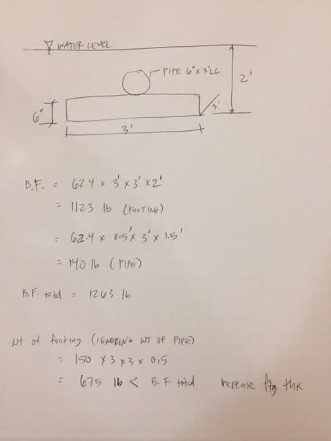

am i right with this bouyant force calculation?
RE: am i right with this bouyant force calculation?
it does not consider the depth of water just the weight of water displaced.

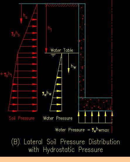

Look at the force at the bottom of footing. It uses the depth of water in the formula.
