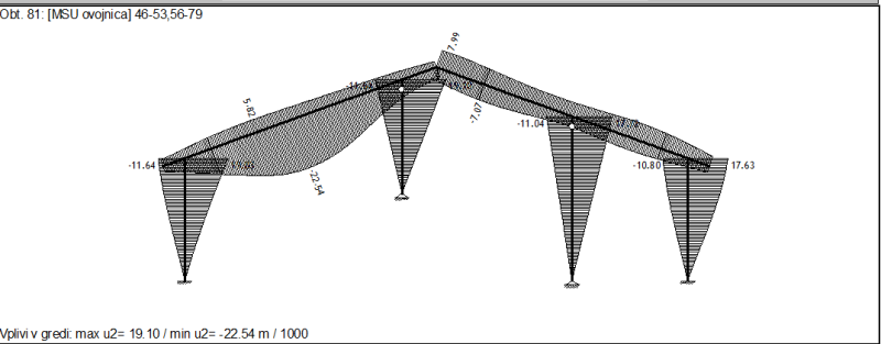

Hi, just yesterday I posted a thread about what do you guys usually do when your expectations dont meet analysis results. In this case I was expecting larger dimensions of steel beam (HEB 240). Its a barn construction (Wolf system) but instead of glulam roof beams I have to make it all in steel. I cant get a second opinion in my company about this at the moment so I hope you guys can help me with some opinions on this.
Barn construction: 10 steel frames in transverse direction that are aprox. 5 m apart. Bases of all columns pinned. Moment connections between top of outer columns and beam and in the ridge.

Envelope of bending moments:
I was comparing a stiffnes of standard glulam (GL28h) beam used by Wolf system - cross section dimensions of 14/48 cm with a steel beam and I have figured that stiffnes of steel beam is higher so based on that it should be allright.

Well the beam (HEB 240) has less than 50% utilization (of the cross section) and is in 'elastic area' in every point.

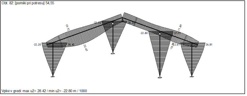

I have checked drift. In a model I have taken into account that outer columns are fixed with 20% fixity of column stiffnes. I have also modeled haunch that is 2 m in lenght from the face of a column.
Drift for load combinations without earthquake:
Drift for earthquake load combinations:
The bending moments, shear and axial forces arent that big... as I said... the beam is not even close to be at max utilization...
But still I feel uneasy with a beam being only 240 mm.

What are the drift values? As in the lateral displacement due to wind/seismic loads?
RE: steel construction - need some validation/opinion
DETstru - I posted drift values in my 2nd post in this thread. Its around 18 mm at the top of columns for load combinations without earthquake. In a case of an earthquake the drift at the top of outer column is approx. 27 mm.
