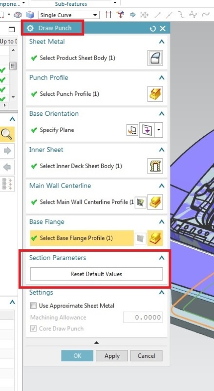

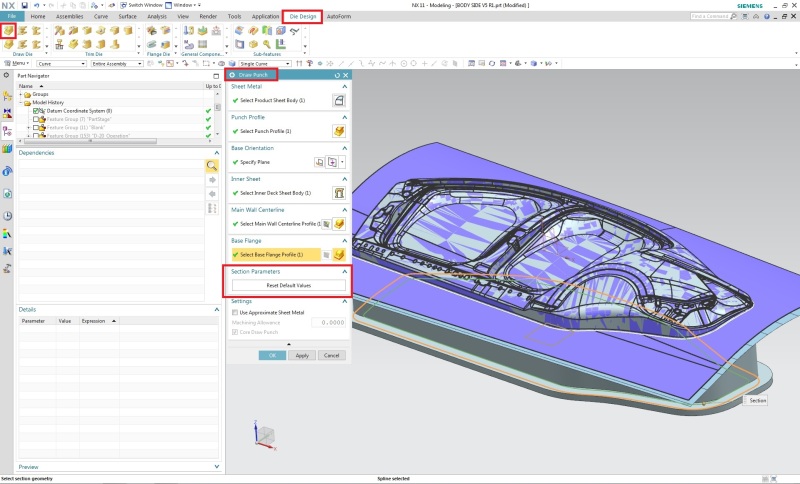

Die Design Draw Punch Section parameters No appears
Die Design Draw Punch Section parameters No appears
Die Design Draw Punch Section parameters No appears
Hello to @ll.
As the tittle post says when i try to use the Die Design tool Draw punch i can´t see the Section parameters.
Somebody know why this happends and how to solve?
Many thanks in advance Kindly regards.
