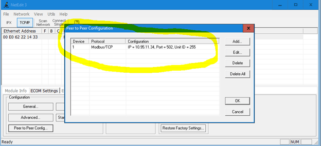

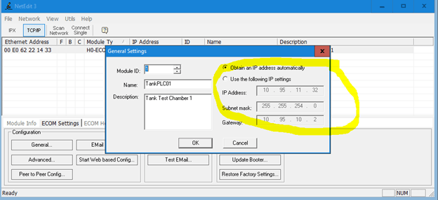

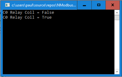

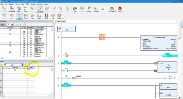

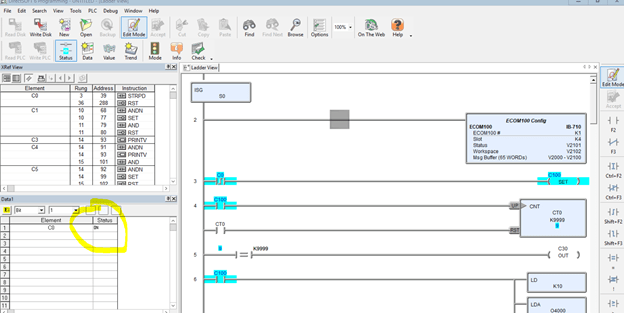

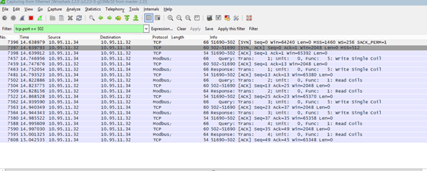

NModbus4 - Listener event not firing.
Please find my C# NModbus4 console application code. The problem I'm having the that the listener event is not firing after setting the master C0 relay coil to true. I've also included some screen shots below.

This image shows the C0 relay coil set off:
This image shows the CO relay coil set on after the console application has run:
Here is the console application screen after running. Note the absence of the "ModbusDataStore_DataStoreWrittenTo event fired!" message.
Here is the Wireshark information that shows the TCP Modbus traffic between the master and slave over port 502
Here is the PLC configuration information:
