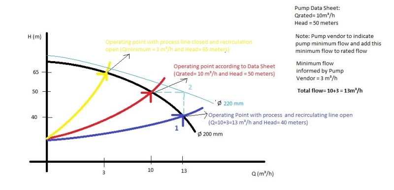

I will try explain a little better.
1) Pump Data Sheet:
-Qrated= 10 m³/h
-Head= 50 meters
-Note: After selecting the pump, pump manufacturer to inform pump minimum stable flow. This pump minimum flow shall be added to rated flow. It will be installed a by-pass line at pump discharge with a restriction orifice to ensure, if someone closes process line, by-pass line will continue operating at pump minimum flow avoiding damage to the pump since it will be pumping the minimum continuum stable flow.
2) Selecting the pump with Qrated 10 m³/h and H= 50 meters, pump manufacturer informed me the pump minimum flow (3 m³/h for the rated impeller Ø 200 mm. Note: I cant' start selecting with 13m³/h because each pump has it own characteristic minimum flow.
3) This is the pump curve for the rated impeller (Ø200 mm).
My doubt is: Literature only tell us what to do with the flow when operating with a continuous recirculating line with restriction orifice. "The pump and prime mover must be sized to simultaneously supply both the bypass flow and the process flow", but don't tell us about the Head.
I only have two options:
1) Operating with 13m³/h and Head= 40 meters for the rated impeller (Ø200 mm) when both lines (process and recirculation)opened. Is that ok? operating with 40 meters instead of 50 meters indicated at Data Sheet? Consequences? (Point 1 at the image).
2) Furnish a Ø220 mm new impeller , that is capable of providing 13 m³/h and Head= 50 meters. But why Literature don't tell us about this option? (Point 2 at the image).
RE: Centrifugal Pump operating with bypass line
Ok,
you don't seem to want to do anything other chose the pump, but for the future, please note than min flow lines are valid in a few occasions, but in many others they are nothing more than a complete wasteof energy....
the choice of min continuous flow is always a bit hit and miss depending on the vendor, but 30% of rated flow is a good place to start. It might be 25 or 35 at the most so you won't be far away.
If your duty is 50m at 10 for the process then that's what you need, not 40m head.
I assume by "literature" you mean the process data sheet? They don't tell you because that isn't their job ( silo engineering at its best), but yours.
There are instrumentation methods available which will trip the pump on low flow / no flow but I guess that isn't your job to investigate that either (silo engineering strikes again) neither apparently installing devices to only send flow down the bypass when it's actually needed. To be fair this is a fairly small pump so it might not be worth it, but larger units the energy loss over a years operation can be enormous, continuously wasting a minimum of 25% of the energy you're putting into the motor.
"After selecting a pump according to Process Data Sheet (operating point: 10 m³/h and 50 meters), pump vendor informed minimum flow for the rated impeller 3 m³/h."
That's when the pump vendor should have read the spec, which, as you have quoted it, clearly states that the operating point of 10m3/h at 50m must be adjusted to include minimum continuous flow.
If the recirc line orifice is sized for 3m3/h continuous flow, then you need a pump selected for 13 m3/h at 50m head.
End of story, and very straightforward, in my opinion.
