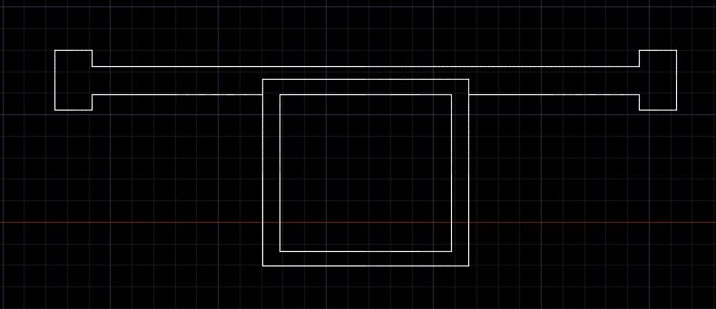

Hi all
I searched the thread but I couldn't find a similar subject.
How the RC beam to RC wall connection be detailed if the wall is spanning up the beam for several floors, while the beam is spanning from one column to the other column (passing the wall between the two columns)?
This concerns to the congestion of beams and walls re-bars in the region of the connection.

I’d recommend posting a sketch so that we can understand your situation. It doesn’t Sound like what I’d envisioned (beam passing through perpendicular wall with full bearing).
RE: RC beam to RC wall connection
Hi
Quote (KootK)
I believe that is entirely different than what Koot was envisioning. Is the wall supposed to support the beam? or is the beam designed to span from column to column?
Quote (jayrod12)
Yes the beam is designed to span from column to column
Can the wall and it's foundation take the load from the beam?
The beam will not span from column to column if the wall is there. The wall provides some level of bearing, stiffness and support. Unless you separate the beam from the wall with an expansion joint (which would not be the thing to do in my view), you have to consider the beam as spanning from column-to-wall-to-column.
The sketch is still not clear. What supports the three walls which do not rest on the beam? Do they run down to foundation level?
BA
I think this is a plan view BA. With four walls (supported below by some type of foundation along with the two columns.
Sort of a floor beam running parallel to and through and elevator shaft wall.
From the perspective of the design and detailing of the beam, I'd be inclined to treat the wall as a large column and design the beam as two span continuous.
Quote (OP)
Can partial bearing of beam on the wall (if the wall thickness is less than the beam width) exclude stirrups (shear strength) from the beam?
I'd say so. You couldn't really fail the beam in shear without also mobilizing the wall in shear. This may not apply at the roof level where your ability to keep the beam tied down tight to the wall is less apparent.

Quote (JAE)
If that is the case, perhaps two beams could be used, each bearing on one corner of the elevator shaft (if that is what the square thing is).
I was under the impression that the wall above the beam did not extend down below the beam, so that the beam was supporting the wall.
BA

Quote (JAE)
Exactly.

Quote (KootK)
- How about you sketch it up and I'll let you know if anything looks out of wack?
Please find the attached picture
What the heck is that?
BA
Quote (BAretired)
It's a section through beam and wall showing wall longitudinal re-bar and beam re-bars

Is there no slab here?
Quote (OP)
If you can provide a sketch of your suggestion for the case stated in the first post. What one should do? Have you encountered such a problem?
I'm confused now. Do you want to discuss the other situation that I commented on in my first post. Or the situation that you posted in your sketch just now? They're different.

@ the OP: are you sure what you are asking about isn't a pilaster/a column built into a wall? You keep calling it a "beam".....but the sketches you have provided remind me more of a pilaster.

Quote (KootK)
Sorry, I didn't draw the slab because the main concern was about detailing so that avoid the congestion in the region of the beam and wall rebar
Are there Elevator doors below the beam?
BA
Quote (BAretired)
Good point. If there is a door below the beam, then possibly you can cut the wall re-bars because it is discontinued in the door location.
Suppose the door is in the direction perpendicular to the beam span length
