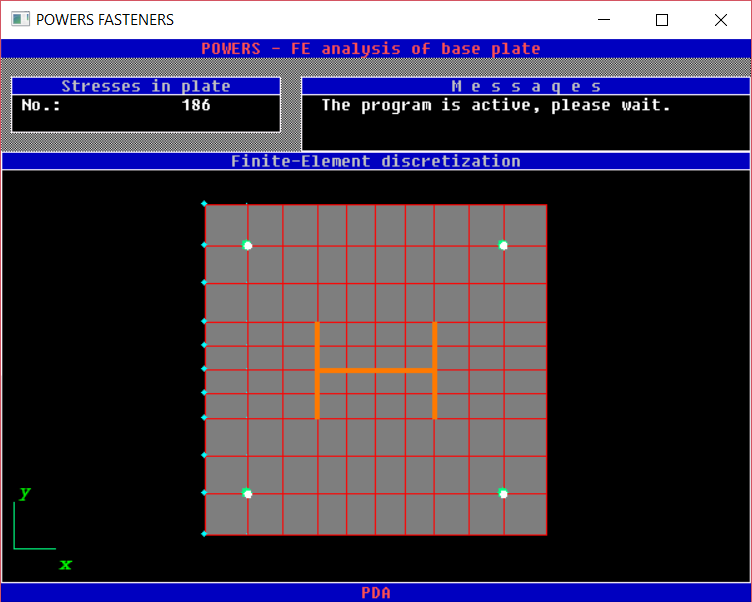

@Winelandv: Yeah, check it out for sure. Obviously keep you spreadsheet up to date too but Powers is nice when you need to spit out a bunch of low-load cast-in bolt calculations. Plus they include a fairly powerful FEA baseplate design tool which I haven't fully verified but appears to be quite accurate. Overall it's a powerful free program.

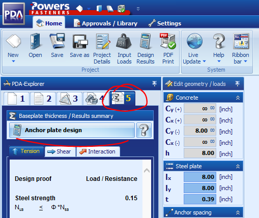

Are you saying The Powers PDA does that baseplate check or Powers has an additional program that does it? I haven't noticed that the PDA does a baseplate check if it does.

acwooten, see below. Also, look in the Powers PDA help file for a great description of the equations used and the checks they make.
