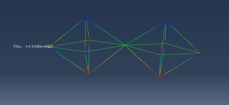

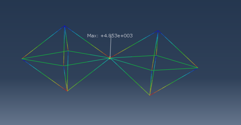

I've attached two pictures to this post that shows that the stress distribution and maximum stress do vary depending on whether you split the beam section definitions into 12 identical or just 1.
12 beam sections:
1 beam section:

I reassign beam section orientation to 0,0,-1 for both models and have got nearly the same results for both models.You have to check tangent directions also.

Thank you for trying to assist me with this issue. So the input files are generated directly by custom software, so the GUI is only used for viewing the results. This means that the tangent directions are always the same for the two files (you can see that the node and beam element definitions in the two files are identical).
I tried changing the beam orientation to 0, 0, -1 for both models and got the same results as above. The model is completely symmetric so I would not expect changing the beam orientation from +Z to -Z to change anything about the model.

I did get in contact with ABAQUS support team and this has been confirmed to be a bug. I will give another update once it is resolved
Thanks for your help!
