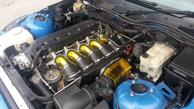

I have a BMW M Roadster and I've been gently modifying using labour and minimal cost - my rules.
I have insulated the intake side of the engine with aluminium shielding and loft insulation and gold insulation tape...
I didn't have any testing software before the exhaust modification (see below), but the "before and after" for the intake modifications show a decrease in the intake temperature and an increase in the air mass flow rate.
Until now, I have been using automobile forums to influence my thoughts and ideas. Since I have found this site, I'd like to seek your thoughts about my future ideas...
I have been looking at ceramic spacers to thermally insulate the throttle body from the engine to further cool the intake gas
Is hot exhaust gas a good or a bad thing?
I have also been looking at spending big bucks on having my stainless steel headers ceramic-coated (Zircotec) to insulate the exhaust gas and further cool the engine bay. Automotive forums think this is a good idea, but engineering forums seem to think it is a bad idea. I'm trying to get a definitive view (with evidence) as to why I should, or shouldn't do it.
I welcome your views (both pros and cons) for my latest ideas.

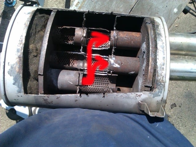

As an aside. To increase flow (I know that you need a certain amount of back pressure) I have gutted the exhaust mufflers...
Original
Modified

An ICE is nothing more than an air pump. By supplying colder (denser) air you can move more pounds of air through it.
That is if you can provide enough fuel to keep the F:A where it needs to be.
Insulating/isolating the intake can help performance.
Insulating exhaust can have various unintended consequences, it will move more heat further down the exhaust system. This will change the normal running temp of various parts and also change the thermal expansions. It might cause issues, or it might not. Where is your O2 sensor located?
Have you done any work on the heads or valves? That is the next place to look related to improving the flow.

Many thanks for the feedback
- It is well insulated and the air intake is drawn from an air duct to the brakes (it is not scooped, so the effect of vehicle speed is negligible - I'm not sure if the engine would be able to handle scooped air. I know that carbureted engines ran overly lean if they were supplied with scooped air.) I've managed to reduce the intake temperature (measured inside the plenum) from 10°C above ambient to around 3°C above ambient. Although the best improvement is the ability to reduce the temperature after a stop. Previously, the temp would rise to around 40°C and not reduce when I started driving; now, the temperature will come down when I restart driving auto.

(I'm obviously not working to McLaren's standards of hygiene!!)

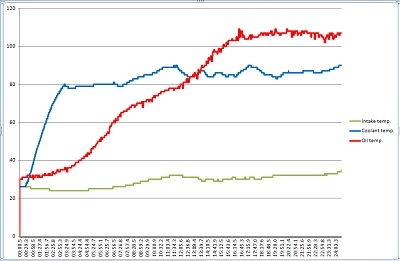

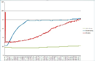

- I would think that there is still sufficient back pressure in the system. I did rig-up a compressor to test the welds (using talcum powder), and there was a back pressure in the muffler, even post-modification.
- I haven't done any controlled acceleration or top speed tests, but I have done several tests using the same test route. Obviously, the driving conditions won't be the same and there are too many variables to eliminate, but I have got some graphs...
Temps before intake mod...
Temps after intake mod...

Another and possibly simpler option for insulating the throttle body from heat is to use a phenolic spacer.
Kyle
RE: Cold intake gas = Good?, Hot exhaust gas = Good?
If you have improved fuel economy at cruise, and acceleration at WOT then you have improved efficiency.
Unless your exhaust system was highly restrictive I doubt that it had any impact on performance. If you go to turbo or supercharged and greatly increase air flows then it becomes critical.
I believe that the guys at Engine Masters (YouTube) have done a couple of these where they swap headers and pipes. They even hammered on a set of headers and at normal HP they measured no impact.
Quote (kjoiner)
Thanks for the steer. I'll phone Tufnol in the morning and see what they say.
[edit] I've just ordered a small 6mm sheet of Tufnol Carp (190mm x 190mm). It has a 130°C continuous use rating, which should be enough. There is other stuff on the web that is only 90°C continuous rated. It will probably be too small to do the job, but it was an off-cut that was being sold off cheap.
I'll see what it's like to machine. It looks like it will be very messy.
Quote (EdStainless)
I think you are right about the exhaust. It's about as good as it will get. The only improvement would be to remove the catalytic convertor, or to tune the tailpipe length. I don't want to remove the cat as I want to stay legal. Tuning the length is impractical as there is no under-car space to get the pipe to the side of the car, and it's too dangerous to allow the pipe to terminate under the car.
