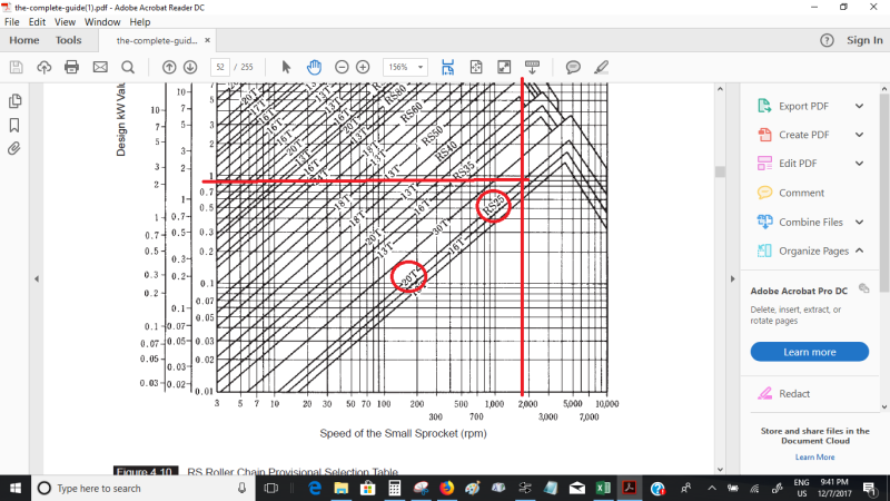

Based on Power = Amps x volts = 4.5 amps x 120 volts = 540 Watts ~ 0.72 HP
At 450 RPM the output torque of the drillmotor is T = HP x 63025 / 450 RPM = 101.4 lb-in
Based on an assumed 1750 RPM motor, it looks like a US Tsubaki RS25 (0.25 inch pitch) 20 tooth driver and 80 tooth driven sprocket would provide a little better than 1.5 service factor and provide a 4:1 reduction to match the drillmotor output speed. Caution to know the overhung load rating of the motor you select. You might overload the bearings with a chain drive, especially if over-tensioned.
