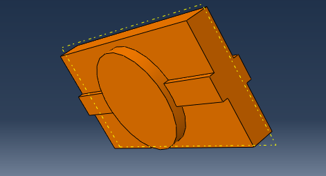

I am trying to create a 3D solid model with different extrusion depths(perpendicular to screen) as shown in the image . The way I was trying to do is:
I created a rectangular solid by extrusion depth of 5e-3mm . And then, I split the central cyclinder with a radius of 2.25mm. But I need the central cyclindrical part only to be of extrusion depth of 10e-3mm and the rest be of 5e-3mm. How can I achieve two cells of different extrusion depth in 3D solid Model?

I don't understand the problem. In the part module are extrude and cut operation with a sketch as basis. So start one of those, sketch the circle and define the value for the cut or extrude depth. Afterwards you can partition to have multiple cells in that part (if needed).

Thank you for your kind response. Sir actually i am trying to create a 3d solid model of a speaker membrane .
See the newly attached imgae. The central cyclindral part is a copper and the rest rectangualr part is a membrane supporting the thiscopper piece. And also u can see 2 small rectangular ribs attached to cyclinder part . Now as shown in the imgae. I want different depths /thickness for each of this as clearly shown in the newly attached image

That looks quite simple. There are several ways to do it. You could sketch and extrude the whole plate first with the smallest height and then add with two mode sketch+extrude the two higher regions. Or you extrude the full block first and then use sketch+cut to remove the material get lower regions.

Thank you so much Sir, I could get it and create my model . Now I was trying to do the python script for the same . This is the code

The findAt() returns you a list. Just add [0] to get the first (and only) entry of that list.
Use print to get information on whats going on.

Thank you so much sir. Now I am trying to mesh this part as shown in the image

I think the line above the error is missing a )

A more serious problem is that Abaqus will fail to mesh that part with the current settings, as indicated by the orange color. In order to produce a mesh of sufficient quality you will need to do some careful and clever partitioning (which is difficult but doable with python), or use tets.
