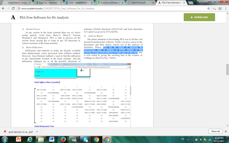

Hello,
How can I obtain the structure stiffness matrix [ S ] using STAAD, ETABS, or any other software? ponder

I think PSA can solve the problem. what do you thik ?
