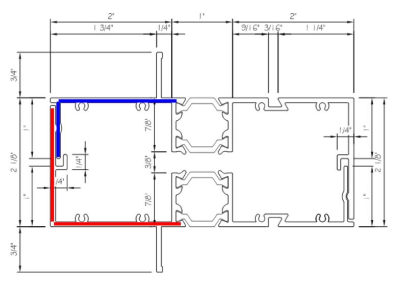

I'm evaluating the capacity of the split vertical mullion system shown below. For the evaluation of flange local buckling, I'm treating the blue and red flanges as though neither braces the other in any way. And that's resulting in very low capacities. Much lower, in fact, that the span charts of other manufacturers would indicate for similar products (Kawneer, Toro, etc).
So my question is this: could I rationally justify either the blue or red flange being braced against local compression buckling at their tips? Or could the red flange be considered to only cantilever from its "connection" to the blue flange? Treating the flanges this way, instead of as fully cantilevered from the side walls, makes a large difference with respect to capacity.
In the wild, I fully expect that this flange buckling would see some kind of restraint. Justifying that to be relied upon for a design assumption is another matter altogether however. There will eventually be some testing.

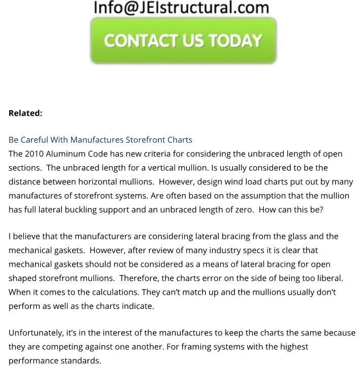

And if you are looking for a more technical, detailed approach on curtain wall lateral buckling, there is a article in the Journal of Structural Engineering (October 1989) by Clift and Austin that gets into great detail.

I believe that you're discussing lateral torsional buckling while, at present, I'm only looking at local buckling of the flanges. With that in mind, do you have any additional advice to offer? I'm trying figure out if I can use that snap together connection to any structural advantage. It obviously doesn't make the mullion a closed tube but, if it could at least brace the flange ends so that the flanges were "supported on two sides", that would make a huge difference. So far I'm not loving it. My suspicion is that manufactures are doing this though.
LTB is a whole other mess but, for now, I'm doing like the CW manufactures and pretending the glass can stabilize things with respect to LTB an weak axis buckling.
Quote (And if you are looking for a more technical, detailed approach on curtain wall lateral buckling, there is a article in the Journal of Structural Engineering (October 1989) by Clift and Austin that gets into great detail.)
This article right? Link. If so, I was checking it out last night. If you say it's the way to go, I'll make the purchase.
What was holding me back from making the purchase was that I wondered if Clift's advice was still valid given 2010 ADM concerns regarding the use of glazing and gaskets as permanent structural bracing. See the blog post below from a notable CW engineer. I've been trying to determine if there's a similar provision in the Canadian codes. So far, I've not found anything. Our latest is only 2005 though.

It's been awhile since I have been in the CW world, but I definitely agree with the post above about many of the commercial store front systems - buckling often neglected, and based purely on deflection.
On the local flange buckling, not sure how handled up north (and my apologies about the US assumption), but I don't remember considering any benefit of interlock for cases like this. Though I do remember many discussions about the benefits of the hook on the inside of the red flange.
In terms of Clift / ADM / ASCE and design "rules", unless something has changed, there were always holes in how to address custom interlocking extrusions.
And I attached a copy of the article (which I haven't really looked at in years - hope it's helpful)

Only via mechanical interlock. Crazy, huh? It's actually the developers intent to have as much slop in it as possible to make it field tolerance friendly.
At first blush, I've been worried that there's little sense in bracing one flange that wants to buckle with another flange that wants to buckle. In reality, I could see it kind of working though. The two flanges would surely have different buckling wave lengths which would not coincide. Who wants to hang their hat on that though, of course.
Do you think? I've been starting to suspect that the catalogs are based on deflection plus yield strength sans buckling. A lot of times they'll say something like "based on Fy = 15000 psi". With local/global buckling in the mix, it hardly seems that simple.
If the "mechanical interlock" did not pinch the pieces together with a good amount of force (and it sounds like they don't).....I would consider them completely independent.

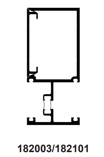

The detail below is from Kawneer's catalog. I don't see how the top flange of that could possibly hold up unless it's assumed to be braced by its interlocking connection. I've tried like the devil to get in touch with their engineering department but they seem to keep those guys behind a pretty tight firewall. They always kick me back to a local sales guy.
I would say the blue flange is unbraced. The red flange is braced at its midpoint by the blue flange to the extent that the blue flange is capable of bracing it.

Oh no, the two channels are most definitely not composite. The only use for the mechanical interlock would be local flange buckling prevention.
Quote (BA)
The red flange is braced at its midpoint by the blue flange to the extent that the blue flange is capable of bracing it.BA
And that's the rub. How to assess the blue flange's ability to brace when it's prone to buckling itself?

At that point I guess you'd be relying on the out-of-plane flexural strength/stiffness of the leg (of the blue & red pieces) to prevent buckling. Interesting problem.
One big issue would still be the lack of connection IMHO. If there really is that much "play" in this system (for ease of field fit)....wouldn't that mean whatever was having to be braced might have to buckle a bit before coming into contact with what is supposed to brace it? (I.e. due to any gap.) That's not going to be a good scenario.
RE: Flange Buckling Restraint
Quote (WARose)
Yeah, I've been wondering the same thing. Gaps are very small. 1/8" or less. I suppose it might be okay if things remained elastic and bounced back after buckling. I'd definitely be curious to know how the CW guys feel about this issue.

It would be very approximate. If we were dealing with steel shapes, we could consider the effective width of each flange. If that were greater than one inch (the length of blue flange), then the blue flange has some capacity to serve as a brace. Using the 2% rule, a permissible force per unit length applied at the end could be assigned to the blue flange based on its moment resistance. That could be used to increase the effective width of the red flange.
The critical buckling stress occurs in a different location than the maximum bending stress, so it seems reasonable to allow them to work together.

In terms of the red flange, the 1/4" x 1/4" "hook" on the inside face could potentially be considered to reduce the b value in the b/t check (i.e. is b just the portion to the top - approx. 1" as opposed to full width - approx. 2")
Again, I have been away from it for a while, but from memory (and as shown in the Kawneer example), I always thought that the "snap" engagement of the interlocking pair worked against each other. In this case, it looks like the lower half (red) could just move to the left, without engaging the other half? Is this a new system, or an existing one?
That is correct. I've actually been struggling to get that very picture out of my head. That's what my imagine locks on to but, in truth, I don't think that's an actual picture of what local flange buckling is. LFB should be all outwards movement rather than side swing think. Still, were I to be brave enough to count on the hook in this way, I'd at least want to expand the overlap a bit.
The thing I wonder with the "snap" or any other kind of interlock (as far as buckling goes is): how stiff is it? If (again) there is some "play" in it......will it really do what you want (as far as bracing goes)?
