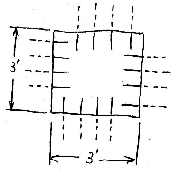

I would drill and epoxy #6 rebar dowels, say 4 dowels on each of the four sides. Suggest a pattern such as my sketch, below, to avoid rebar congestion in the corners. This still allows one dowel be located reasonably close to each corner. Evenly space the dowels, without regard to the location of the existing rebar. Ideally the drilled holes will be near the center (vertically) of the existing slab. You may have to adjust to miss the existing rebar mat. Use #6 rebar (5 bars, each way) inside the patch, positioned to tie to the dowels.

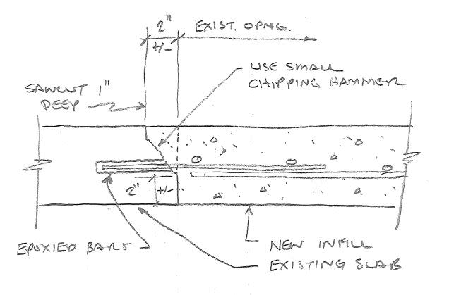

We've used a detail like this one - with variations depending on slab thickness, etc.
