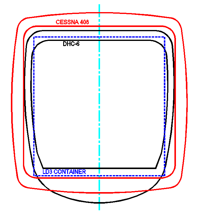

btw, "Otter" is the DHC3, "Twin Otter" is the DHC6.
That pricing is stunning, maybe Viking should protest "dumping"; a la Boeing vs CSeries ??
But I guess the major difference is that the DHC6 was never designed for the LD3 ... I don't think it existed in the early 60s !?
Although it does have a big cargo door ?

The original Otter, and the derived Twin Otter that uses the same basic fuselage, were designed to haul crates measuring roughly 4 feet wide and high. There are no standard containers that fit that space. There were no standard containers at the time of the Otter type design, as others have observed. The smallest LD that I could find was only slightly smaller than the LD3, but still far too tall to fit in the Otter cabin or through the door. A very very rough sketch of the Cessna 408 cross-section, superimposed on a fairly accurate sketch of the Otter:
