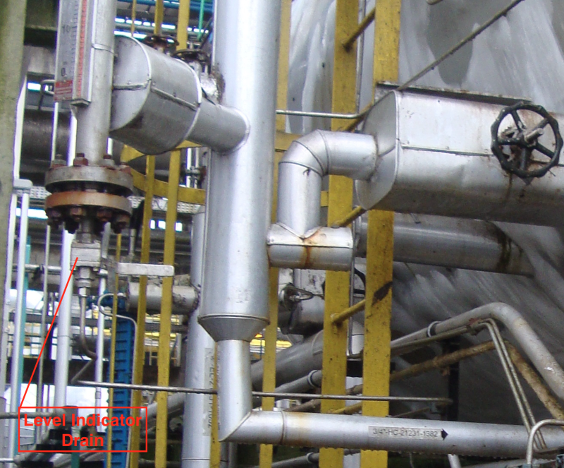

Dear,
I am having problems with level measurement in a vessel.
In this vessel, we have 2 level transmitters (one for safety and one for control) and both are DP transmitter with diaphragm seal.
Those transmitters are connected in different process connection, being them:
- Control Level transmitter connected directly to the vessel.
- Safety Level transmitter connected in a StandPipe (Bridle)
The superior and inferior connections of both transmitter have the same elevation, in other words, they supposed to have the same level indication.

MEASUREMENT PROBLEM:
Although the transmitters are equal and have the same elevation in their process connection, they present different percentage level indication:
The instrument that is connected to the standpipe (Control - Green Line ) always show its indication below the instrument that is connected directly to the vessel (Safety - Blue line ).
MY HYPOTHESIS:
1) Calibration mistake
Once they have a different system (Foundation Fieldbus and 4-20mA) maybe occurred any mistake in calibration process (range selection and parametrization).
I saw the configuration and both have the same calibrated range (-850mmH20 to -320mmH20).
Any of you can see any calibration mistake can cause this kind of error between this transmitters?
Can some AI block parameter cause this difference?
2) Measurement Difference Cause by Process (StandPipe x Vessel)
After I went to the field I started to think that this error could be caused by a Convection Flow between the standpipe and the vessel.
If the standpipe has a higher temperature, can it cause the difference between the transmitters?
As they are DP transmitters, I think just density variation (static analysis) does not explain the difference between them, once they are calibrated with same range.
Is the vessel work in a thermodynamic equilibrium?
The Standpipe has a Magnetic indicator (304L body - not insulated) and seemed to be at a hotter temperature than the vessel. I used a pyrometer and the temperature of the Magnetic Indicator surface was 20 Celsius Degrees (positive and have way more temperature than -28 degrees of the vessel).
Once the magnetic indicator is not insulated, Could it induce error caused by excessive heat transfer? Can it make the temperature in standpipe hotter than the vessel?
Can the evaporation in the standpipe be causing a flow due to the convection phenomenon?
If yes, I think it causes a different pressure in both transmitters. See figure below.
Thank you very much for your attention.

RE: Help - Difference Between Two Level Transmitters (DP diaphragm seal)
The configured range looks good; with a difference of 530mm H2O from LRV to URV. 530mm/0.53 = 1000mm HC.
If the HC boils at whatever the temperature the standpipe is at, then yeah, you have flow as you indicate as the tank refills the standpipe as HC boils off. There might be convection flow between the standpipe and magnetic level bridle
My guess is that a major component of the difference in level is that every 'closed-system' pressure instrument is also a thermometer (Charles or Boyles Law) and that the differences in level can be the difference in temperatures of the high or low side capillary impulse tubing. If the capillaries are isothermal, any temperature effect should null out between high and low side, but temperature difference creates a pressure error.
There are no units on the trend chart. I assume it is mm, so the third point shows a difference in level of approximately 10mm?
A 10mm error is easily achievable with difference in capillary temperatures. Buried in the vendor's specifications for any capillary remote seal transmitters is a note that accuracy if x.xx% at reference conditions. It is unlikely that both transmitters' capillaries are maintained at reference conditions or ever at equal conditions.
It is not clear which trend is for which device
Your statement >standpipe (Control – Blue line) always <snip> below <snip> the vessel (Safety - Green Line).
does not match the graph because the graph's blue trend is always a higher level (not lower) than the green trend.

a)Pls describe or add a sketch of the internals in this vessel which show the overall liquid level control and interface level control.
b) Are these LTs' in total liquid level detection service or interface level detection ?
Though this may not be relevant, we see a tubing line in the photo coming down to the bottom of the photo - this tubing line is pocketed - is this for one of these dp cells ?
If these 2 dp cells are in interface level detection service, I can see a design error - there should be an equalising line from the vessel's hydrocarbon phase to the standpipe to make the interface level in the standpipe the same as in the vessel.

Both instruments work for total level (level of liquid hydrocarbon).
They are installed in a position that is expected to have condensed hydrocarbon. So they are not designed to measure the interface between liquid HC and Glicol+water.
The tubing line that you mentioned is the drain line of the magnetic level indicator. During normal operation, It is closed.
See the drain with details.

This readout anomaly is strange indeed. Could it be that the level standpipe ( which leads to the control LT) has a vapor space vessel connection located downstream of the vessel vapor demister, while that for the safety LT (which is directly mounted on the vessel body) has a vapor tapoff upstream of the demister?
By the way, the tubing line mentioned earlier is the one near to where you have superimposed the vessel direct mount LT. This is the tubing line which you can see is pocketed as it comes down to grade.

Looking at the first diagram it shows a low point in the standpipe where water and glycol would collect at the low point skewing the level reading in the sight glass making it read lower than the level in the vessel due to a slug of high specific gravity water/glycol. This should be easy enough to prove by draining some fluid out of the low point.
I wonder why this piping arrangement, normally the bridle connections are horizontal with no low spots?
Where is the interface between the Hydrocarbon and the water/glycol, if it's too high of course water/glycol will flow into bridle
However in the photograph it shows a line off the bottom of the standpipe, I assume this drains any water collecting in the bottom of the bridle but again if there is any significant flow in this line it will cause the level to indicate low. I call this the coffee pot effect, I'm sure you have noticed how the level gauge drops to zero as you fill your cup (only half in jest).
This could be proven by briefly stopping the flow.
Why are you using filled systems, it would seem that just regular DP cell would do?
There is a significant temperature difference in the diaphragm seals, that could also account for a zero shift especially in the SIS transmitter.
We have tried to use filled systems for measuring interface with limited results, similar quality instruments effected greatly by ambient temperature changes.
Do the cells read identical when the system is shut down, zero flow in and out?
A) The oil in the vessel applies it's head to the water in the bridle but being heavier it only pushes it half the distance up the standpipe.
This IMHO is poor piping design. the pipe between vessel and bridle should be horizontal all the way with no pockets.
You should be able to guarantee what is in the bridle.
B) As I pointed out earlier there is a pipe at the bottom of the bridle, we don't know what that is doing, any flow in the bottom connection will cause a significant level difference in the bridle.
Would the original poster explain that line?
Is it possible to drain the pocket by opening whatever valve is in the line, this would prove A)
If there is a steady flow through the small line close it for a minute or two proving B)
