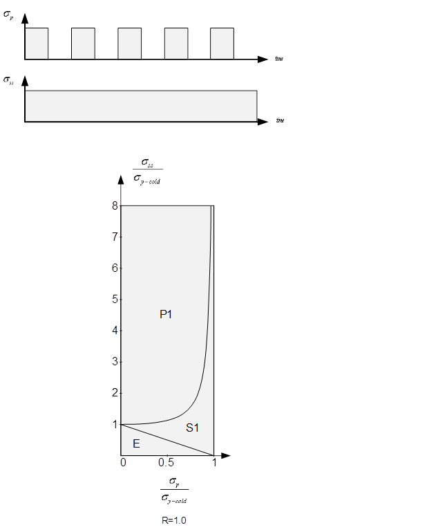

You'll need to research the work by Bree. He answered this type of question.
I have a figure that shows this. I'll try to find it on Monday.
RE: Ratcheting VS Incremental Plastic Strain
The image is not a good quality. I think the P1 is cyclic plasticity and S1 is elastic shakedown.
TGS4, I have a more basic question regarding ratcheting. My question is why ratcheting is important at all?
Suppose a case in which there is a primary stress and no secondary stress. If it is subject to a cyclic load in such a way that it undergoes some inelastic strain then upon unloading there will be some plastic strain remaining in that location. Then the cycle is repeated and an incremental plastic strain will occur. This is a case of fatigue loading in which there is a mean stress more than zero. Apparently since there is no secondary stress there is no ratcheting at all (as per the definition in the code). However, there will be incremental plastic strain.
An incremental plastic strain which is caused by a secondary stress acting on a primary stress: Ratcheting--As per the code must be prevented and must not occur at all.
An incremental plastic strain which is caused by a primary stress: Not Ratcheting--As per the code need not be prevented and has to be dealt with in fatigue design.
Why is there this much obsession regarding ratcheting and not about incremental plastic straining caused by primary stresses.
In cyclic primary membrane stress and constant secondary stress, ratcheting cannot occur. Go search for Bree diagrams via google - you will see many different situations (hopefully some have better quality). Region P1 is cyclic plasticity without ratcheting, while S1 is shakedown after the first half-cycle.
Your example will not ratchet because the primary stress limits prohibit stresses that high.
Why is there this obsession with Ratcheting? Because when it happens it can cause catastrophic failure. Look at all of the different Bree diagrams - there are certainly situations where cyclic secondary stresses can occur to cause ratcheting. More importantly, though, is the assurance that when you have either purely elastic action or achieve shakedown in the first half-cycle, then the assumption of no cyclic plasticity built-in to the fatigue curves is assured. When you have cyclic plasticity, then you need to adjust the pseudo-elastic fatigue stress range - hence the K_e factor.

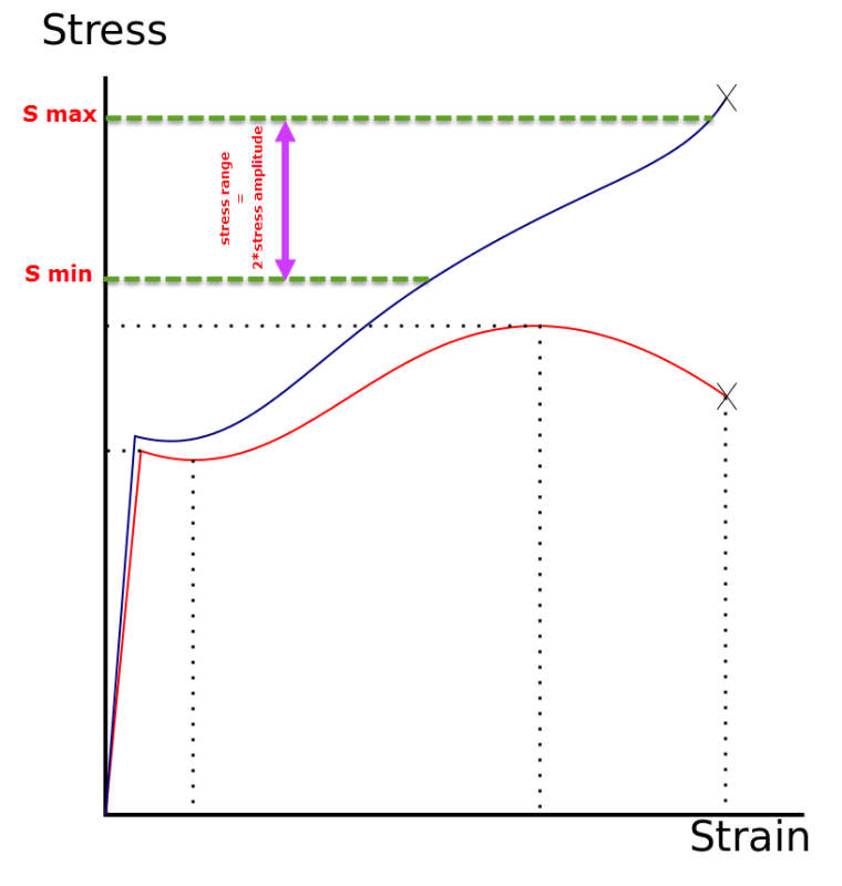

TGS4, I have a couple of questions. Can you help me understand?
1-Are the stresses referred in table 3-F.9 of ASME BPVC VIII-2 true stress or engineering stress? (unfortunately I did not find the units for the stresses I assume it is ksi)
2-What is the meaning of maximum possible effect of mean stress in 5.5.1.4?
Quote (ASME BPVC VIII-2 edition 2015)
5.5.1.4 Stresses and strains produced by any load or thermal condition that does not vary during the cycle need not be considered in a fatigue analysis if the fatigue curves utilized in the evaluation are adjusted for mean stresses and strains. The design fatigue curves referenced in 5.5.3 and 5.5.4 are based on smooth bar test specimens and are adjusted for the maximum possible effect of mean stress and strain; therefore, an adjustment for mean stress effects is not required. The fatigue curves referenced in 5.5.5 are based on welded test specimens and include explicit adjustments for thickness and mean stress effects.
From what I see in this paragraph the effect of mean stress cannot be neglected at all. If you have mean stress you must either have access to some S-N curve data which includes the effect of mean stress or one must consider some theories like Goodman to include the effect of mean stress.
If I want to have a judgment about what code says about maximum possible mean stress then I say the maximum stress is very close to UTS. Like what I have shown here.
Do you have access to ASME PTB-1? The mean stress correction is discussed there. Suffice it to say that the mean stress level is premised on the stress levels covered in the other failure modes.
Otherwise, elastic fatigue is based on the stresses being pseudo-elastic. There is no plasticity, except with the Ke factor. Unless you use elastic-plastic fatigue, in which case the curves are well described (if not extremely difficult to implement).
