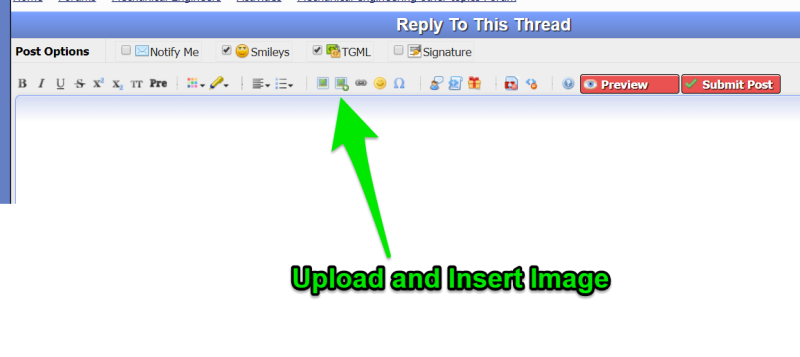

Please use the Upload Image feature to insert images.

RE: Synchronizing Shafts in Parallel
The OP did insert a picture.
The OP "attached" a file that happened to be a picture.
The Upload Image function inserts an image directly into a post.
Lots of people don't want to, or are prohibited from downloading random files from the internet.
Inserting an image directly is far more helpful to the people who are trying to help understand and answer the question.

Mint - Ok, but I find inline pictures to be a problem because they often are scaled down to illegibility. I suppose they could do both.
