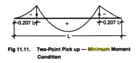

For minimum moment of a two-point pickup of a uniform distributed load on a uniform crossection (the rebar bundle qualifies) the answer is always the same. Magnitude of the uniform load (rebar weight) does not matter.
Total length does not matter.
The answer... two pickup points, each 0.207 x total length from the end. That is, each pickup point is 3.73 meters from the end of the 18 meter long bundle.
Minimum moment is probably a better critera than minimum deflection, but the answer is probably about the same.

Thanks, WA. I missed the 9 pick up points. Agree to forget that plan. IMHO, the chances of the load being anywhere close to evenly distributed on 9 points is nil. Calculations on that subject are just an academic exercise, not a practical answer.

So if we have two lift points at say 3.75 m from the end, the deflections will be very small and we just need to check the stress.
For a single bar the maximum (unfactored) stress would be 184 MPa, and the maximum stress in bars acting as a group would be much less than that.
