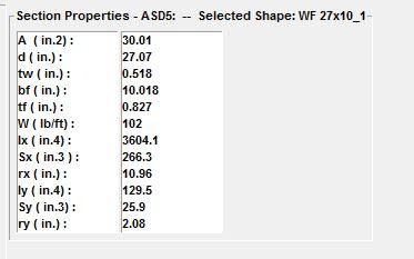

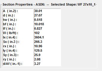

I am trying to find section properties for an I-Beam that looks like a S section with tapered flanges with d=27" and b=10.125"
The flange thickness goes from 0.68 to 0.96 inches.
My guess is that the building is about 70 years old. A quick search of historical data wasn't much help.the S sizes go up to 24 inches only.
Can anyone direct me to any other publications or references.

Based on those dimensions it would closely match a WF 27 x 10 from either ASD6 or ASD5. The Flange Thickness is ASD6, don't have a copy of ASD 5, is the mean thickness for sloping flanges, have an old hard copy of ASD 6.

I was thinking standard beams and channels used a 1:6 slope on the tapered flange, which would give quite a bit more variation that what you're measuring. That's closer to a wide flange profile than an S-shape profile.
RE: Steel Section Properties
In old steel I've often found sections that don't fit in the published literature precisely. I usually envelope the design with the closest historic section and my field measurements.

Thanks. I also estimated the section to be close to a W27x102.

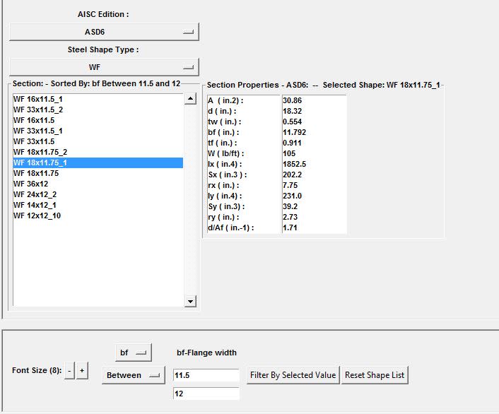

You see, this was one of the sections. I have another that is not as easier match as this one.
It has a d=18" and bf=11.875" with tf=o.71 to 1.09"
The edge of flanges taper quickly to zero.

kxa,
freely available to anyone from the link in my signature, it's built off of the 14th edition excel files AISC provided for free looks like they have updated to the 15th edition on their site now.
Open Source Structural Applications: https://github.com/buddyd16/Structural-Engineering

check back in like 30 mins and I'll put compiled versions of the two shapes databases they don't have much going on under the hood so compile to like 20 mb.

Thank you for posting the program. It worked very well and does save a great deal of time.
