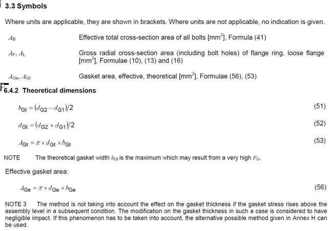

I am designing a simple thermoplastic lined/GRP (aka FRP) reinforced, vertical, cylindrical, 30 m3 atmospheric tank to EN 13121-3 - which is a new (fifth attempt, very complicated - written by a subscript obsessive) standard - in response to the EU PED.
Tank has low level (on shell), 600 dia manway, full face flange, fully bolted, with soft gasket and cover-plate. Pressure at flange invert (from static head) is 0.56 bar.
EN 13121-3 calculation (to verify flange) requires 'effective gasket area using EN 1591'. (That is 'Flanges and their joints: design rules for gasketed circular flange connections).
It could mean - the mean diameter of gasket x Pi x gasket width; or it could mean a narrow area wholly within the bolt circle; or, something completely different.
Can anyone offer assistance?

I would encourage you to buy the standard. The price is fair what the standard offers. If understood and practizied well, it offers serious improvements to conventional flange & gasket design methods such as BPV VIII-1 appendix 2, and the likes. That being said, it's not an easy standard.

Many thanks for your descriptive reply.
So it was mean diameter x pi x width after all..
I have no objection to buying standards that will be in frequent use; but £228 for an answer to one question?
