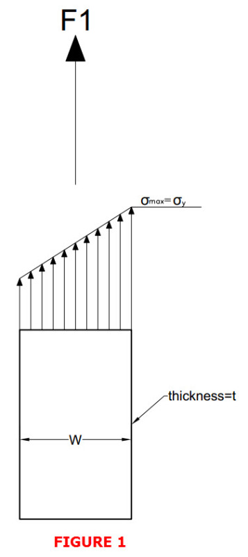

Suppose that I have a plate of width w and thickness t. This plate is a part of a component which is subject to many loads. All the loads are load controlled. The state of stress is as shown in figure 1.
Here the maximum stress occurs at the right edge of the plate. Suppose the loading has a value that this maximum stress is equal to yield stress. What happens then? Nothing happens since just on point has reached the yield and no plastic collapse will occur. Note that by integration of the stress over the area of the plate section the force acting on the section will have a value like F1.

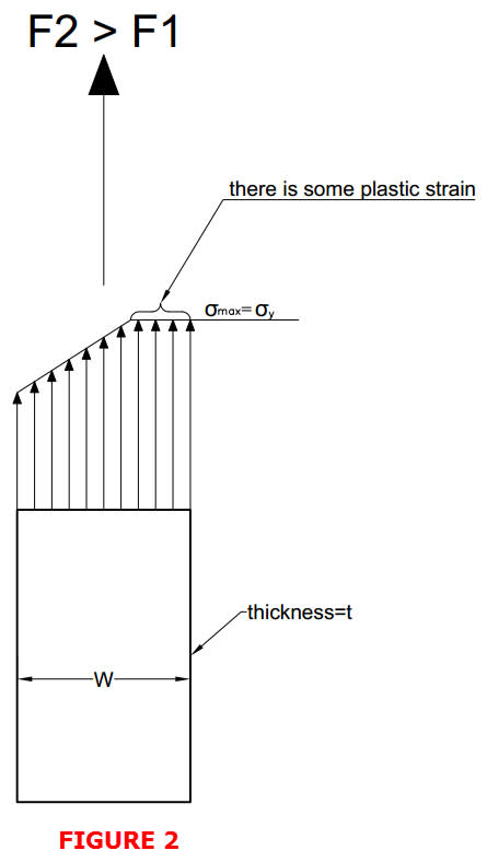

Now the loads increase and the magnitude of the force F1 increases to F2. The state of stress will change to what is shown in figure 2. Here, the points that reached the yield stress are further strained without any increase in stress value. In fact whatever the load is increased the stress does not go higher than yield no matter how much big the strain value becomes. It is the nature of an elastic-perfect plastic material model. The loading can increase further until the whole section reaches yield stress. from this point on any increase in the load is not possible since the maximum possible load for the section will be fmax = sy*t*w. An increase in the load is not tolerated and leads to unbounded deformation. I can understand that this method is conservative since in practice there will be some strain hardening and the section actually tolerates more load than what is predicted here.

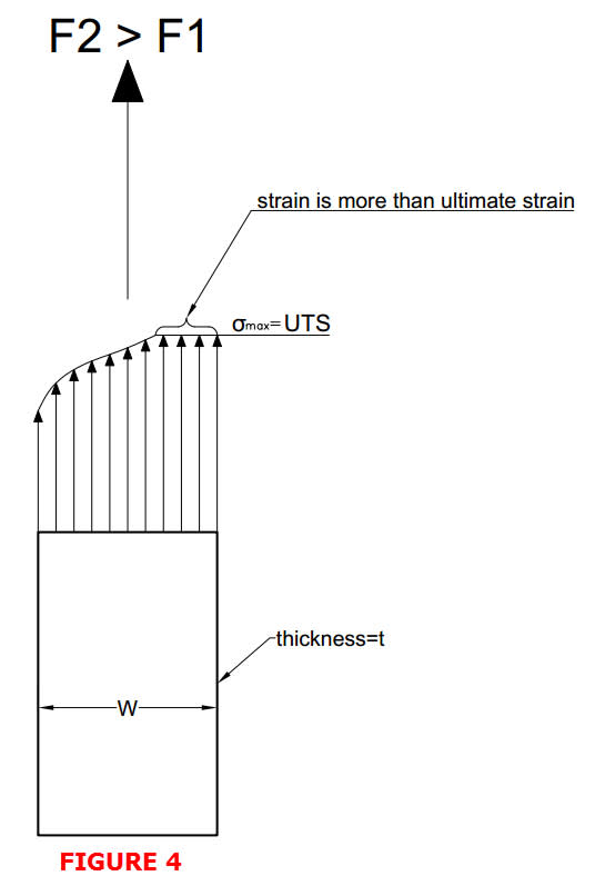

Now I want to consider the same geometry with strain hardening. After strain hardening I consider perfect plasticity. If with some loading the stress at the edge of the plate becomes the UTS then nothing happens again since there are other areas with lower stresses as shown in figure 3. Note that by integration of the stress over the area of the plate section the force acting on the section will have a value like F1.

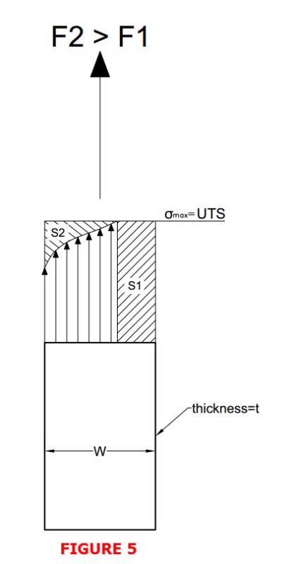

Then the loading increases and the load F1 increases to F2. The state of stress will be the same as figure 4. Here, the stresses are distributed over the section in such a way that there will be an area with stress equal to UTS. This area has a strain which is more than ultimate strain. In fact in this area first the material is subject to the UTS stress and after that further straining occurs. If the loading increases in such a way that the load F2 = UTS*t*w then any further increase in force will lead to structural instability. OK this is what the FE model says and to my eyes this is not conservative.
I call it non-conservative since after reaching UTS any further straining will lead to rupture at the location. Rupture means the elements will no longer carry any load. Not only it means the stiffness is zero but also the load at the location has to be zero. Setting the stiffness equal to zero is not equivalent to element death in the sense that the elements still can carry loads. Figure 5 is the real representation of the status of the plate. Since the loading is load controlled the stress distribution has to compensate for the area that has ruptured (S1). The integration of the stress has to be F2 but this time integration is taken over a smaller width not the whole width (w). In fact, if in figure 5 the area S1 is larger than S2 the whole section will fail due to rupture.

Unfortunately, your analysis is a little too simplified. First thing is that you are trying to make a 1D problem into a 2D problem, but in reality everything is 3D, which starts to mess with your math and even your ability to "eye=ball" the problem.
There's a couple of things that I would like you to consider when doing these types of thought experiments. First, once you exceed the proportional limit, you will start seeing some deformation. The deformation in a state of primary bending will be towards reducing the bending. Think about a flat plate (really the only structure that exhibits primary bending) - the bending will tend to want to deform the plate into a shape that will eventually take the load in membrane tension. Internal pressure on a plate, to an excess that would reach anywhere near UTS, will result in a hemispherical head - hydroforming in other words. You will never achieve primary bending reaching UTS because of this deformation.
Second, the deformation is taking place in a 3D sense because of the Poisson's Effect, both elastic Poisson's and plastic Poisson's (which is generally regarded as a constant volume process). All of which makes the analysis much more complicated. because you need to be thinking in terms of von Mises equivalent stresses to determine when the element centroid becomes perfectly plastic, but in the context of the deformed shape (hence the need to be inputting the stress-strain curves in terms of true stress-true strain).
Third, regarding "conservatism", is the understanding that we have different design margins when we are comparing to perfect plasticity for yielding (limit load) vs strain hardening followed by perfect plasticity for ultimate (elastic-plastic).
Fourth, just as with perfect plasticity in the limit load method, all that perfect plasticity at the end of the curve is that the plastic strain values are non-physical. Which is OK for plastic collapse, because we aren't interested in the exact values of plastic strain like we are for local failure. Which is also OK, because the actual loads that the structure will see is 1/β_T of the load to cause collapse.
I hate (really hate) to say "trust me", but that fact of the matter is that the elastic-plastic method and the underlying method of LRFD work and are much more robust than the elastic or limit load methods. It may be a little bit more of a black-box approach, because the software is performing all of the load-shifting and such for you, but to me that is one of the benefits. My engineering effort is significantly reduced when I outsource my effort to the computer.
