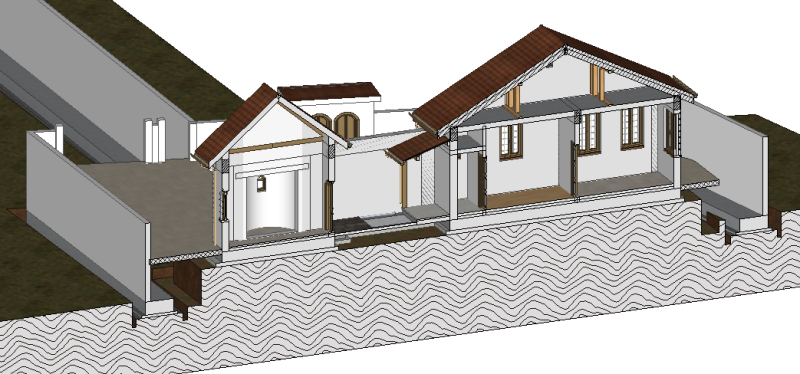

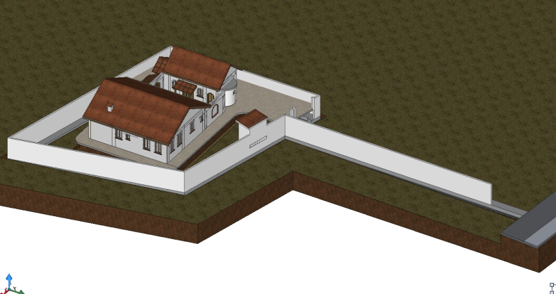

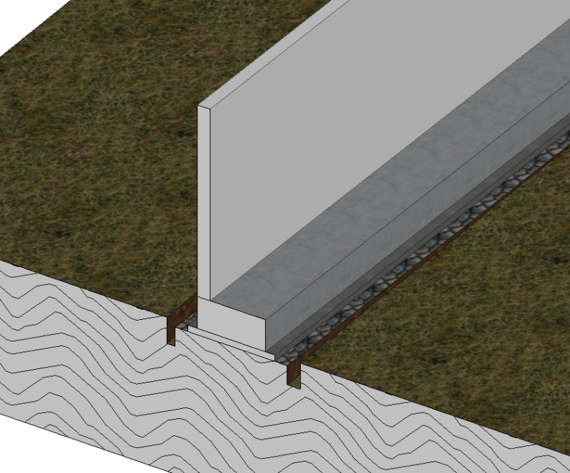

Hello everyone, I am designing a 3.5m high retaining wall of which 2.0m will be covered by infill soil. see picture attached
I have specified a layer of bitumen felt to be applied on the wall up to 2.2m high.
Next on top of the bitumen felt i have specified the installation of a geodrain membrane.
Do you guys think i will also need to specify additives to the concrete such as crystalline waterproofing?
Regards

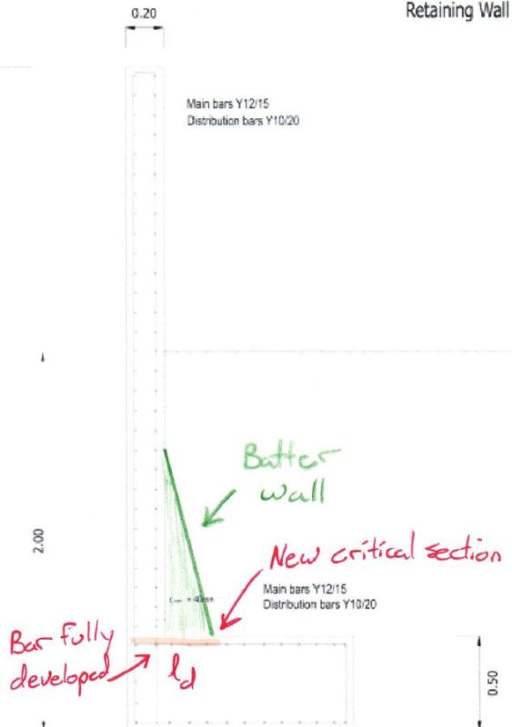

For a 200 wall, do you need two layers of rebar? and you should batter the wall into the soil by 70 to 100mm... so, when it rotates, it becomes more vertical. Also free draining back fill and drains at 1200 with rodent screens.

RE: RC Retaining Wall - concrete additives required?
Hello everyone,
The only reason I wanted to provide waterproofing to the retaining wall is because I have seen crystalline waterproofing being used on slab foundations for residential houses here in my country,
therefore i was just wondering if they also use it on retaining walls since they are mostly in contact with soil.
Thank you everyone for your advise, I will make sure to add the detailing for the backfill with a freely draining material and also add a drain pipe at the bottom of the wall, however where is that drain pipe supposed to take the water to? Also how am i supposed to provide an inclination to the drain pipe?
Quote (WARose)
By the way, why no toe on the wall footing? Are you near a property line?
You are right i am exactly on the boundary of a plot which needs to be filled with soil to increase the level height in order to reach the level of the road
According to my calculations no actually i do not need two layers of bars, but i am being carried away by other engineers designs here in my country, which makes me feel a bit worried to go along and use only one layer while an experienced engineer uses two layers
What exactly do you mean by "batter the wall into the soil by 70 to 100mm"
The drains at 1200 with rodent screens you mention are called weep holes?
Anyone have a picture of the drain pipe with geotextile used on a retaining wall?

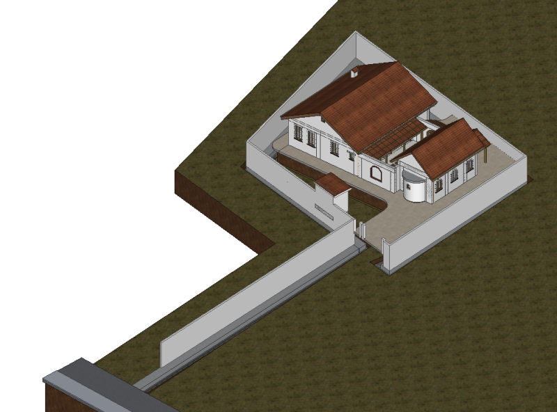

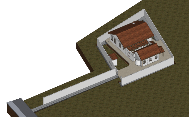

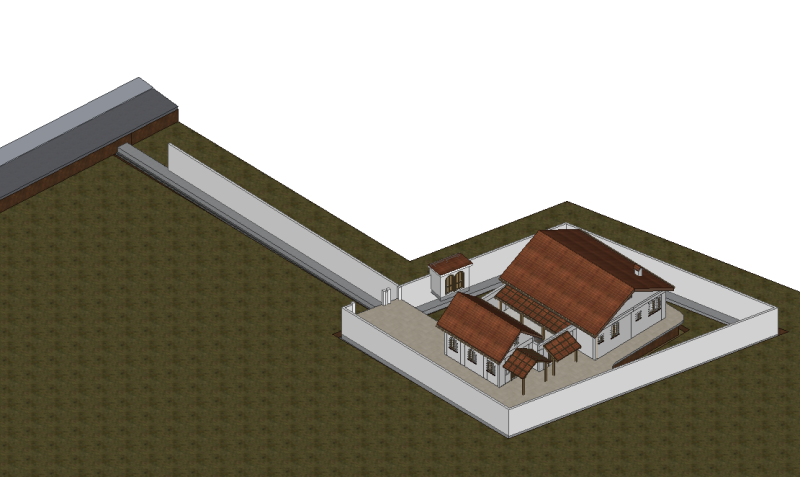

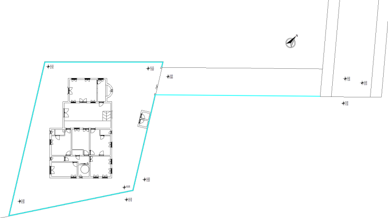

Any idea where I should drain the water to from the bottom of the retaining wall? Please have a look at the pictures below ti get an idea of the site layout
Blue colour in the plan view below is the retaining wall
Unless your concrete placement is really good... I'd not use 2 layers of bars in a 200 wall... 250 wall minimum for 2 layers. You're looking for segregation issues.

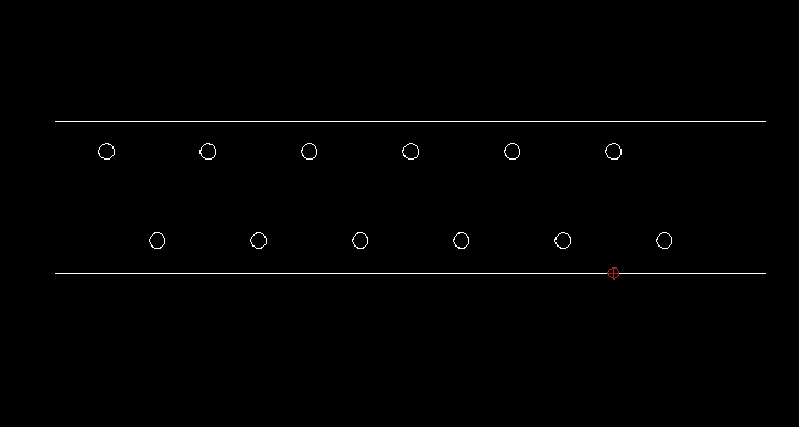

Thanks for the advise, actually i have seen quite a few 200mm thick being build and poured just fine however the bars of each layer are alternating, what i mean is that one layer is shifted by a distance = half the spacing of the bars therefore the bars of each layer are not exactly on the same axis. see picture for clarification.
However another important reason to use only one layer is the cost savings
so from the top view of the wall it would look like this

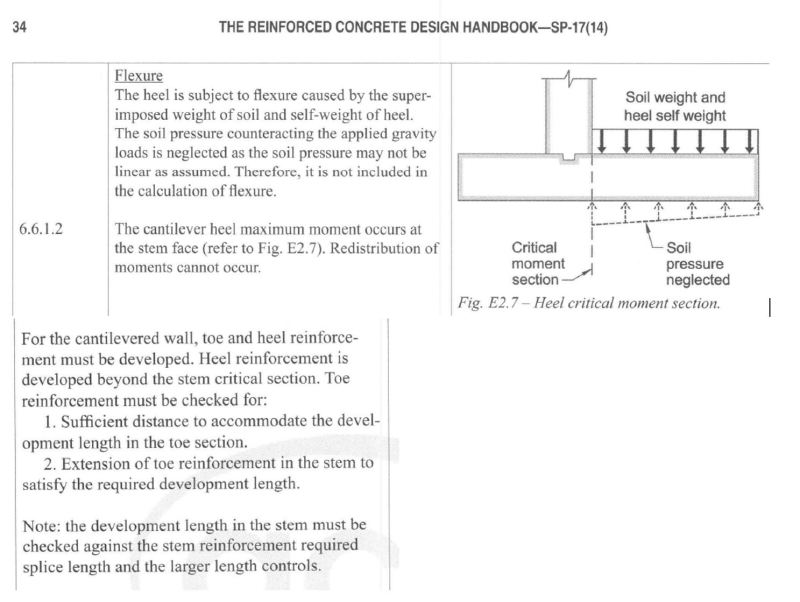

Currently you have a cantilevered wall with no toe due to property line issues. I am concerned that your heel reinforcement bars will not be fully developed since you only have the stem to work with. Have you considered battering the rear side of the wall. A battered wall is thicker at the base, which will push your heel's flexure critical section rearwards. That will give you more room to develop the steel in the heel.
Below is an excerpt from ACI's Concrete Design Handbook showing the critical section for the heel. The CRSI Retaining wall design guide has a similar discussion about development length of heel bars.

kellez: You shouldn't stagger the vertical reinforcement. If same spacing, then the bars should be opposite each other. I should have added that it's the horizontal reinforcing that causes the segregation...

Kellez - For a "thin" (200 mm) wall, have the Contractor construct short lengths of the wall. Whether there is one rebar mat or two, there is no room to get a tremie pipe or concrete pump hose to get inside the forms. Agree with Dik about segregation and there is an additional concern:
As the concrete works it's way down inside the forms, it coats the rebar with concrete residue. If the wall is placed quickly (a short length of wall) this is not a problem. If a long length of wall is constructed, it may take too much time to fill the forms. The residue on the upper rebar may have "set" before it is covered... affecting the bond strength.
Thanks for the advise, the stem reinforcement will actually continue down into the foundation and be part of the bottom layer reinforcment of the foundation, i will soon post a more detailed reinforcment drawing so that you may advice if this would help with the heel reinforcement bars to be fully developed

Hello guys,
quick question, how thick do you think the gravel base for the wall should be?
By the way the contractor for the retaining wall suggests that we do not need to add the gravel base, what you guys think?
What are the soil properties of the subgrade?
Compared to the bottom of the footing, where is the water table?
The gravel must have been specified for a reason... what is that reason?
If the gravel is deleted, will the Owner receive a credit (money) for material and labor not used?
I believe you have a good Contractor. Sounds like he realizes the importance of keeping things simple (refer to my 3 December post).
www.SlideRuleEra.net idea
www.VacuumTubeEra.net r2d2
