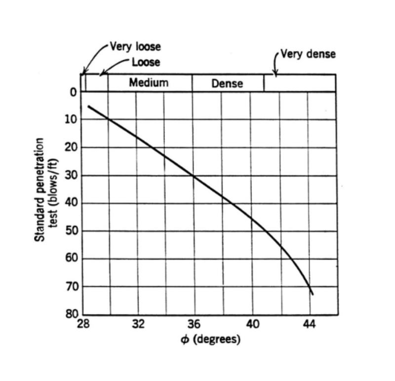

Here is a chart from Peck and others.

You did not mention the depths for your N-values. So, perhaps you can also consider for checking the phi values based on the effective stresses and N60 values. Then use the proper phi for the depth of influence of your foundations. See attached correlation chart from Coduto's book.
