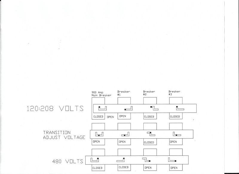

Here is a sketch of what the sliding bar will look like. When the breakers are closed, they lock the bar in position. When selected breakers are opened, it is then possible to slide the bar sideways to a position that allows selected breakers to be closed.
This is an illustration with three positions.
In practice I would use 5 positions so that none of the switching breakers can be changed when the 900 Amp breaker is closed.
