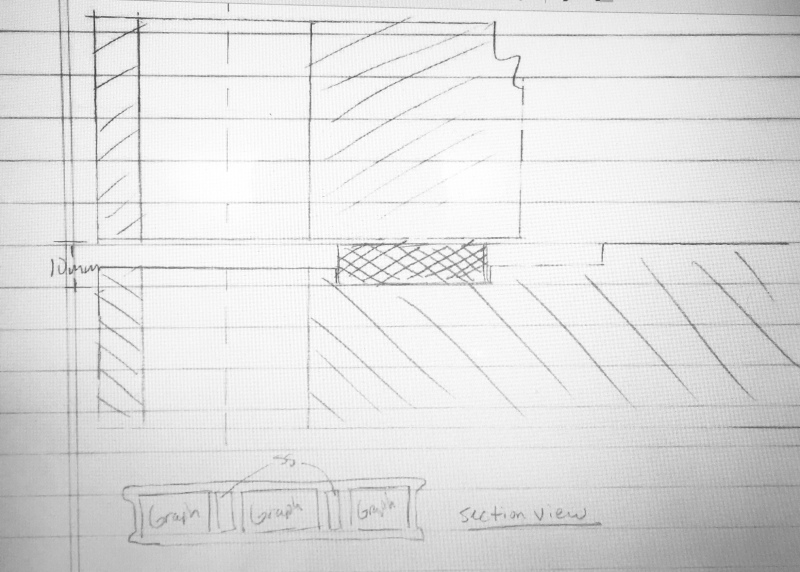

The gasket being utilized in the hydrotest has previously provided sufficient sealing in the past; however, during the most recent catalyst changeout, the gasket failed numerous times during the hydrotest prior to startup. The failure location is the interesting part of the equation - the leak point was always located wherever the gasket seam resided during the test. The gasket is a 10mm thick gasket with an alternating layer system: graphite-ss-graphite-ss-graphite (arranged horizontally). These layers are wrapped in a ss foil and there is a seam where the gasket ends are joined together.
The hydrotest was performed, unsuccessfully, multiple times. The location of this seam was adjusted during each test in an attempt to rule out warping or deformation of the head / tubesheet as a cause. The leak point followed the placement of the seam and did not occur at any other locations.

I am attaching a detail of the gasket as it was communicated to me (forgive my poor sketching). The groove that the gasket sits in I believe is 2mm deep and I believe the gasket itself is 26mm wide.
Unfortunately, I do not have any actual fabrication drawings that I can share.

Unfortunately I cannot get the sketch to upload. My apologies.
With regard to the seam, it appears to be physically joined. I believe a small weld was made to join the ends together. I noticed what appeared to be a very minute indentation in the edge of the gasket where the weld was made, so that may be where the leak is introduced.

I’m attempting to attach the sketch again this morning.
With regard to the gasket diameter, I believe the bolt circle of the vessel is 2780mm (44 bolts) but I do not have access to the actual drawing to confirm the actual gasket diameter. I also do not have M & Y values for the gasket at this point. I can only relay what I have been given thus far.

Have you calculated the assembly bolt load per ASME PCC-1 Appendix O? Forget m and Y, do you have the ROTT gasket constants Gb, Gs, and a? If you don't, ask for them - the gasket manufacturer will have them.
Do you have the gasket contact surface finish in accordance with PCC-1 Appendix C?
Do you have the gasket contact surface flatness in accordance with PCC-1 Appendix D?
Do you have the flanged joint aligned in accordance with PCC-1 Appedix E?
Are you using bolted flange joint assemblers trained and certified to PCC-1 Appendix A?
Have you followed the troubleshooting guide in PCC-1 Appendix P?

All, the feedback here has been very informative, so thank you all. My understanding is that the plant has now been able to complete a successful hydrotest. They were able to bring back the same manufacturer’s rep (engineer) that presided over previous tests - he was not available during the failed testing.
Apparently the two key issues were surface finish and surface cleanliness. Those procedures must not have been followed 100% as had been done in the past.
