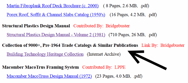

Here's another link. This is a great site, 1000's of old catalogs.
Link
They have a book that may also be useful; "Handbook of Hollow Building Tile Construction" from 1922. I tried to upload it but apparently it's too large a file.
RE: Historical Clay/Terracotta Foundation Block
BB... excellent link... I'll send SRE a copy of the link. Downloaded the book, but, too large to upload to this site.
Dik
thanks Dik. I've found a lot of great reference material on that site.
