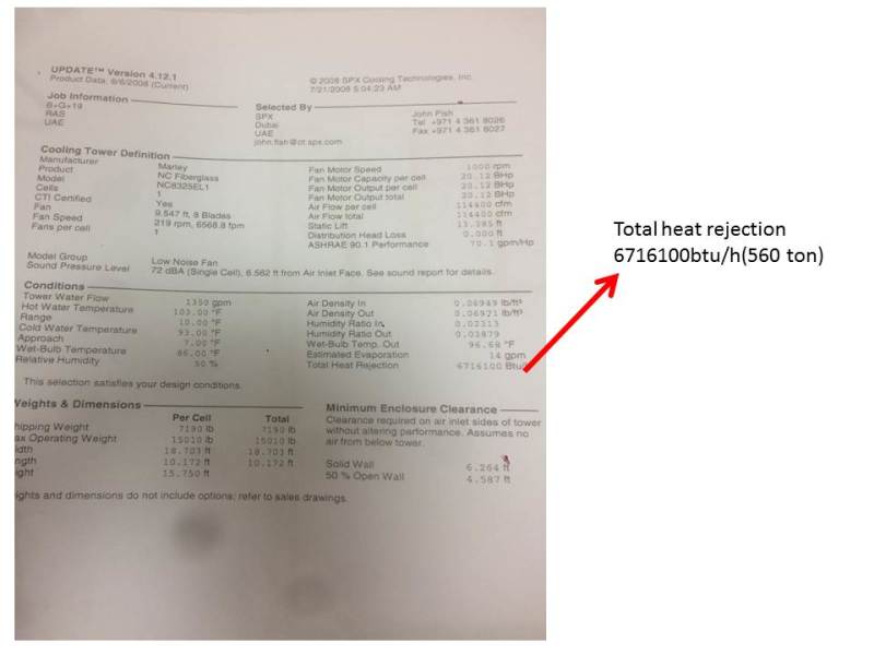

I have a cooling tower; capacity mentioned in submittal that 450 ton. Centrifugal chiller capacity is 450 ton. Very clear cooling tower is undersized. In the summer running two towers for one chiller. As per the same document, the condenser flow rate is 1350 gpm and range 10F. Then capacity will be 1350*500*10=562 ton. I don’t know what happened in design and selection time. I am planning to increase the capacity and improve the efficiency of chiller. Stiil I have a confusion, why the design eng selected 1350 gpm for 450-ton chiller
RE: COOLING TOWER SELECTION WRONG
It seems that the system designer was unaware of the first law of thermodynamics.
Specifically, a 450 ton chiller produces 450 tons of cooling. It needs to reject more heat than that because, thermodynamics.
The energy that the chiller uses to make cold must also be rejected by the cooling tower.

This may be a case of a refrigerant ton (12,000 BTU/hr) vs a cooling tower ton (15,000 BTU/hr). Refer Ashrae Handbook chapter 39 for backup.
The industry decided many moons ago to match the nominal capacity of cooling towers to the nominal capacity of water cooled chillers, this having a 450 ton chiller matched with a 450 ton cooling tower. Why? I guess because the IP system is not complicated enough!
I ignore nominal capacity on most products now and focus on the actual performance data from my selections to avoid such confusion. Nominal capacities are at best ballpark accurate, at worst confusing and misleading - as demonstrated in this instance.

I don't think your cooling tower is undersized. The cooling tower suppliers use 15000 Btuh to calculate Equivalent chiller tons. In your example, 1350 gpm *500 * 10 = 6,750,000 buth. Divide this by 15000 = 450 tons or rather cooling tower tons. If you divide the result by 12000 you will get the tons of heat rejection. (562.5 TR).
Best way is to check the chiller selection and cooling tower selection and check if the flows and temp in/out match between the 2. Looking at tons will be confusing as the Chller tons and Cooling towers are based on different calculations.

i re-checked the submittal and selection sheet.in selection sheet clearly mentioned 560 ton, but in submittal 450 ton.i think as "boss88" pointed is may be correct. but in actual practice. one chiller cannot run with one tower. find the attachment..

I would not worry too much here. What you have is simply a written process description. They simply called the cooling tower a 450 TR tower same as the chiller capacity. I don't think they even thought of mentioning heat rejection in that description. What you need to look at the actual values which are on the selection sheet from SPX and the chiller as well. Here it shows 1350 GPM at 93-103 and 86F WB which is correct for a 450 TR chiller.
This is a very old selection so I guess it is an existing project which is in operation. Now if you are trying to say that you are not able to operate the plant with 1 chiller + 1 towerand need 2 towers for that, that is a different issue (technical) and discussion. From a selection point of view, your datasheet is correct. From an operation point of view, you might not be able to operate 1 tower with 1 chiller but that would be more a technical investigation you need to look at. Probably better to call SPX Dubai for that.
One more note: if you look at the heat rejection capacity on SPX selections, be aware that they adjust it as well for specific heat and specifc gravity (BTUH = (Flow) X (Range) X 500 X (Specific Gravity) X (Specific Heat)) so it will not be exactly 15000 btuh. This is why you have 6716.1 MBH vs 6750 MBH. Evapco uses 15000 BTU and BAC does not provide this value on their datasheet (i guess to avoid the confusion between chiller tons and cooling tower tons)

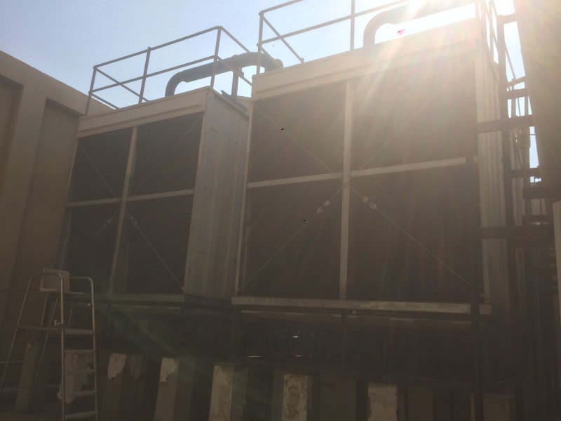

From the pictures, I can see the plant is surrounded possibly by wall? you could simply have a case of hot air recirculation which increase the inlet wet bulb. Also you need to look at how they control the fan (if on VFD) with respects to condenser setpoint.

Bos88:yiua are correct,tower is surrounded by wall, it also in planning to make ventilation for tower area.here one chiller is standby.ct fan is controlled by vfd, but here vfd manually adjusted to full speed.

Consider also adding cooling tower discharge cowl to discharge exhaust above the wall enclosure to avoid recirculation of discharge to intake. Confirm also that the distance between the wall and cooling tower is at least equal to the height of the cooling tower fill.
