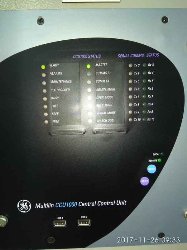

the GE multilin 1000 has an Ethernet port. ive attached the photos from our substations.do you mean that we can connect the CCU to a router and then to the internet. without the need of a specific gateway?

i work on a powerplant and we have 02 CCU1000 for brakers management and signalisation since 2009 , we are experiencing a failure on one of them , the CCU 1000 don't start i mean don't want to boot , the green ready led is "ON" but nothing is displayed on the screen .
we took contact with GE for replacement and they said that this model is old and is no more manufactured , they advise us to upgrade to another model .ed
can you help me for more diagnostics ?
