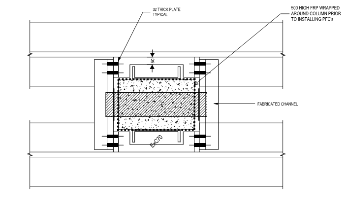

Hi All,
I would be interested to get peoples opinion on the design of a shear key around a column which receives the load from a transfer truss supporting part of a 14-storey building. Please could forum-users read this in conjunction with my attached sketch which is intended to convey alot of the information you might need to reply. I would like any discussion on this but am interested in failure mechanisms. I am especially interested in the my interpretation of the shear failure which I would appreciate comment on.
I would undertake a bearing check between the shear key and the concrete
- As there is a eccentricity between shear key and the applied load from the truss, Macalloy bars are to be used to provide equilibrium and they would be pre-loaded to maintain a clamping force and prove the installation.
- The shear failure would be a vertical shear failure akin to the maximum shear capacity achieved when designing a beam for web crushing at supports. Thus a significant shear strength can be mobilised in the concrete - in AS3600 this is approx 0.2*f'c*do*b where b is column width and do = height of column above shear key. The column would be able to mobilise this capacity above both shear keys.
- Steel design/stiffenrs/welded connections etc obviously required
- Bars to be preloaded to unfactored tension load.
- Load in column is approx 2000 kN dead and 250kN live (construction loading)
- I will probably use two shear keys stacked on top of each other to achieve safe bearing stress on to concrete which is driving design at the moment.
To ease peoples fears, my line manager has tasked me with producing a draft design for this, then he will check it thoroughly and is a very experienced engineer. I will not be designing this solely off of the back of advice on the forum but it will help me to understand the problem and thus present a sensible, worked solution to my manager for review.
Many thanks in advance.
Attachment link: http://files.engineering.com/getfile.aspx?folder=a...

Something about relying on a 50mm key to transfer that much load doesn’t sit well with me. What’s the cover? Are you going to be close to cutting rebar? Personally I wouldn’t rely on the outer cover of a column to transfer that much.
Your sample building looks like there’s access to both sides of the columns. Is that the case for your project? If so you could sandwich the columns with trusses, something like in the attached.
RE: Shear key design for to support column in 14-storey building
CANPRO, thanks for the reply.
With regards to the cover, it is 50mm (to the shear reinforcement). We will not being cutting any rebar.
There is access to both sides of the column but the connection between the truss and the concrete brings its own troubles - the anchorage required would be prohibitive i.e. size and number, I did look at this solution initially and discounted it. It required many large anchors, some of which would no doubt hit rebar.
I was too initially skeptical when I was shown this as a concept but it has been used successfully on one of my managers previous projects of which I saw photos of the finished install.

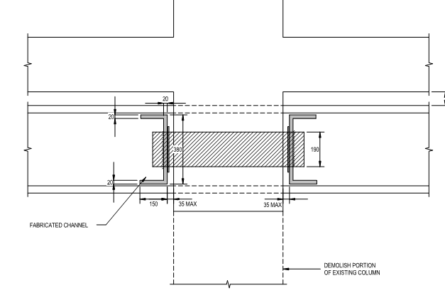

I took a look at the failure surface that you drew (thanks for that), could you explain what is happening there? how would you determine the depth that could be that you have drawn. With 2 shear keys in height I need approx 800mm to mobilise sufficient shear strength based on the shear web crushing strength given in the code (i.e shear strength = 0.2*f'c*b*d where b = width of column engaged by the shear key and d = 800mm). Have I mis-understood the failure mechanism here?

1) This makes me nervous too on a gut level. But, then, I long ago learned that I really can't trust my instincts when it comes to construction engineering. I'm too much of a coward by nature. If I trusted my instincts, nothing would ever get done. And, of course, your bosses example makes for one valid data point.
2) I believe that it's erroneous to be treating this as anything akin to conventional beam/truss shear. I don't anticipate any failure modes that would justify that kind of treatment. And I worry that taking web shear crushing strength over the entire height of the column below the shear keys will lead to a spuriously large capacity.
3) This bears considerable resemblance to the problem of steel column base plate shear lugs. In the US, we have AISC Design Guide #1 to give us some guidance with that. As one of my checks, I'd run this case against those procedures. The AISC method won't fully capture your problem though as the critical failure mode is often shear breakout of the concrete behind the key based on the available edge distance. Here, you've essentially got infinite edge distance. And that's great. We just have to search for something else meaningful to check her in order to establish capacity.
4) I also think that this problem resembles an anchorage problem far more than a beam shear problem. So I'd check that out a bit too. In the US, we'd use ACI appendix D provisions to evaluate that. No doubt you've got similar provisions in Australia as it's all based on the same euro-research anyhow. The failure mode that I feel would be most relevant here would be pryout. That mechanism keeps you from being able to mobilize extremely long lengths of concrete for resistance. Interestingly, your clever use of pretension to address eccentricity could also be used to deal with pryout which is also a result of system eccentricity. You'd just need to pay close attention to ensure that you're putting the pensioning where it needs to be vertically to do this job successfully.
5) How will you be prepping the shear key joints to ensure uniform key bearing against the column concrete? I have some ideas but I'd like to hear yours first.
6) This might be a good application for a post-tensioned truss if there's space. It would give you excellent movement control and would create a natural clamping action at the column supports.
7) One failure mode that I would investigate is the separation of a wedge of concrete below the shear key. They cover something similar in the PCA Concrete Handbook. Usually you're studying a case with an outwards horizontal thrust which makes thing worse. Without that thrust, I'm not even sure that it's possible to generate failure with this. I'd want to check it out anyhow though. Basically, you check shear friction on a bunch of possible failure planes to make sure than none are a problem. You use the bearing stress perpendicular to the assumed failure stress as clamping force, similar to if there was rebar there.
8) Another failure mode that worries me is creating a delamination failure of the concrete outside the column cage (also sketched below). It's probably paranoia but I'd either find a way to evaluate the potential for that or, more likely, I'd jacket the column with whalers or something for a few feet below the connection, until I was confident that the axial loads had spread into the column core sufficiently.

Delamination failure as mentioned in KootK's 8) above and shown in his sketch (b) is also one which worries me. It becomes more critical if the column is heavily reinforced. Jacketing the column may prevent buckling of the 2" wide strip, but the plane in contact with the reinforcement cage is weak.
I would prefer a solution where shear is carried by grouted through bolts rather than a shear key. This would entail X-ray of the column in order to locate reinforcement.

On the question of core drilling and losing column area - your current proposal would remove 2 x 2"x25" = 100 sq.in. at a particular cross-section. So core drilling in the 20" direction of the column, you could drill 2 - 2.5"Ø holes and install 2" thru-bolts while still dealing with the same cross-section loss as the current proposal. As mentioned above, you could phase in the installation of the thru-bolts to limit the total loss of column at any given time.
I'm not a fan of the key way for loads this large, but I have to admit that its a slick way of tying into an existing column. Would you be able to share any details of the condition this was used before? Approximate loads? Maybe a picture of the finished installation? I would love to see it if you're able to share.
