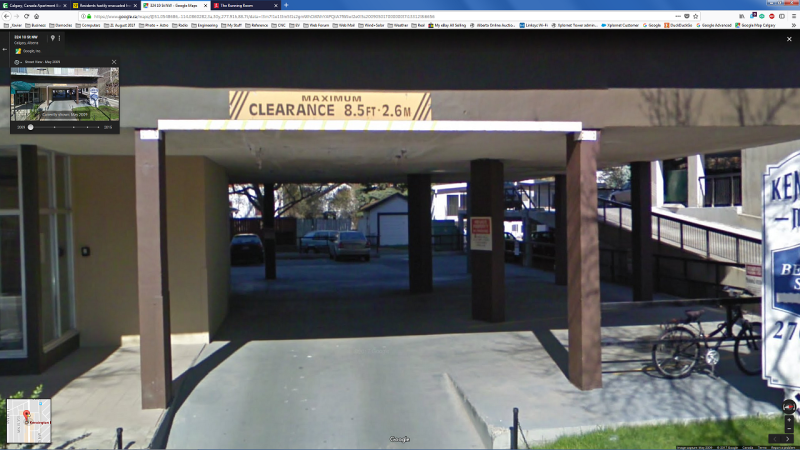

I wonder if it's an issue with one of the columns the section of building supported above the drive through area. Not much redundancy if one of those columns gave way.

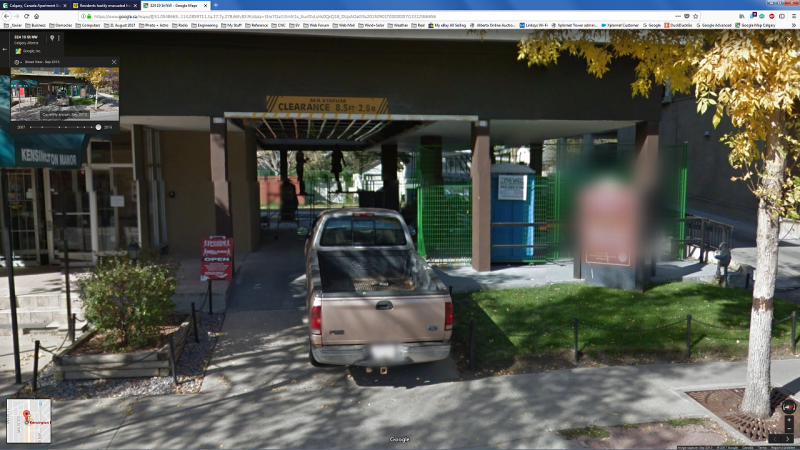

The current Google Maps Picture shows construction workers and fences around the parkade. And a porta-potty so you know they were working there a while.

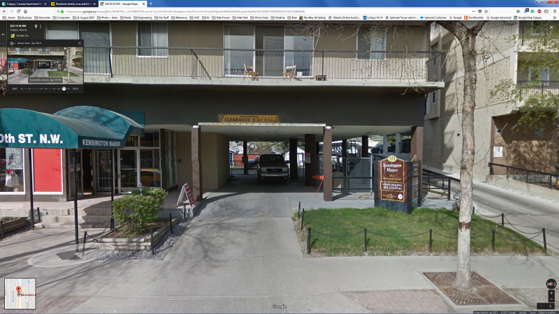

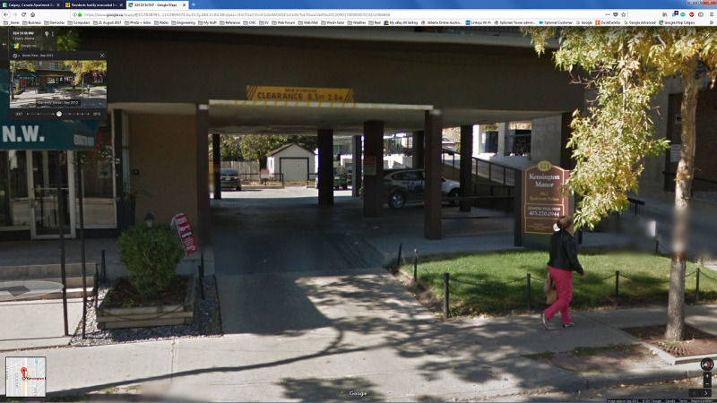

Rolling back in the history of Google street view reveals some of the history of the work on the parkade.
But that may be a red herring: The news stories show pictures of people walking casually under this area.
2009 May, stuff peeling off the ceiling:
2012 September, ceiling has been refinished:
2014 April, ceiling peeling again:
2015 April, partly parkade fenced off:
2015 September, parkade ceiling cut away, workers on scaffolding busy under the second-storey floor:
