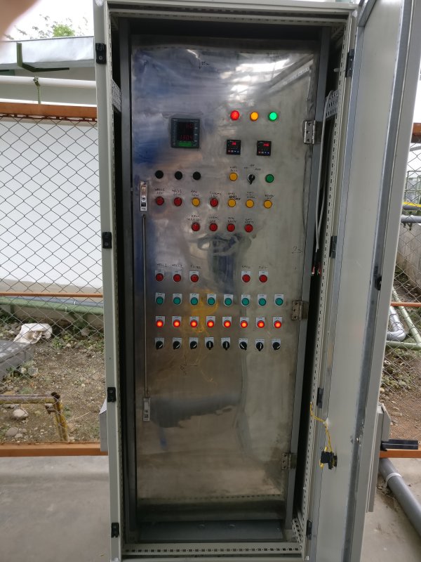

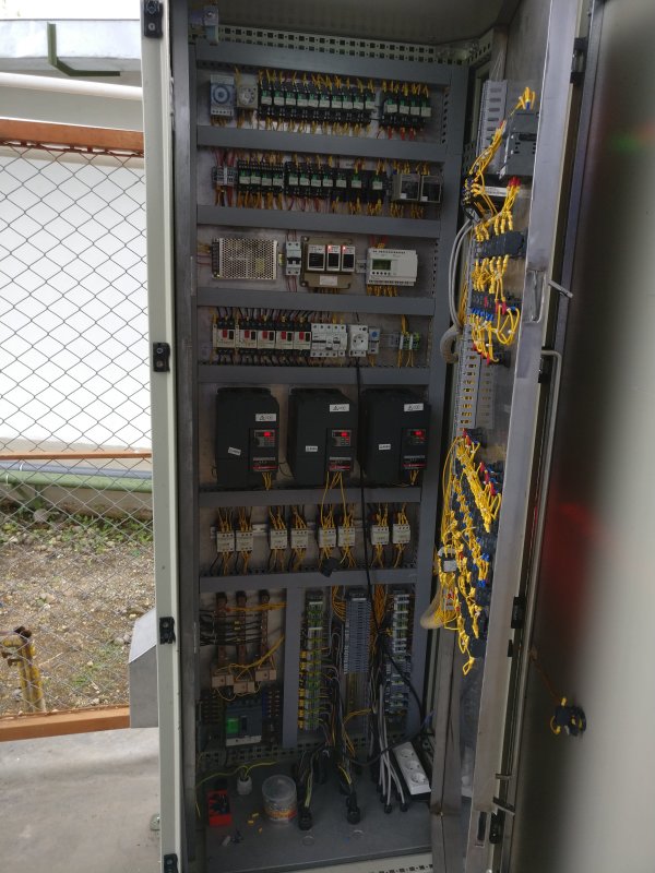

Sorry about the delay, here's the pics I promised previously.
Would there be a point to trying looking around with a scope? Or is this not something commonly done on controls panels?
RE: control panel ghosts
Well you're looking for a signal or lack thereof that may be transient. There is a chance that one of the field wiring runs is picking up a lot of noise that at times exceeds a thresh hold and causes a trip, so I can't rule out checking inputs with a scope.
Looking at the power to the flickering lights may be a good idea. Look also at any control signals to any led drivers if there are any such circuits.
Personally I would follow the following protocol:
1. Start by looking at the latching relay that is dropping out; It may be a faulty relay.
2. Look at the control circuit and identify and list all devices that may send a signal to the latching relay to drop it out.
3. Scope the input to the drop-out coil of the latching relay to see if there is any noise on the signal line.
4. Check each device on the list generated at step 2 for physical damage or wear.
5. I suspect that you may have one or more alarm relays, driven by a 4-20 ma signal. If so:
a) Look at the 4-20 ma signal coming into the relay with the scope. You can monitor the voltage across the relay. That voltage will be dependent on the current, no need to open the wiring.
If you have a problem with process pressure variations this should show up in the 4-20 ma signal. Note: the scope will show pulsating pressures but you may miss one time transients.
b) Go back and check the engineering on the loop controlling the alarm relay;
i) Add up the input impedances of all devices in the loop and make sure that the maximum allowable resistance does not exceed the maximum allowable resistance for the supply voltage.
eg. With a 24 Volt DC power supply feeding a 4-20 ma loop, the maximum resistance allowable is 24V/20 ma = 1200 Ohms.
Add up the listed resistances of all the devices and verify that you are not getting close to the 1200 Ohm maximum loop resistance.
Anecdote: I once had a problem with an alarm relay failing to operate under alarm conditions. The relay was intended to initiate a safety shutdown when the loop current reached about 19 ma. The relay was off spec and the input resistance was greater than specified. As a result, the loop resistance was too high and the maximum current that the power supply could generate into that loop was about 18 ma. The relay several times failed to respond to alarm conditions with resulting equipment damage.
6. Look at your process for conditions that may develop a transient pressure pulse.
A pump discharging into a fairly long straight discharge line may develop pressure pulses if operated at a forbidden speed. Fast acting valves and rapid changes in the flow rate may develop pressure pulses. (Think Water hammer).
If possible ramp up the speed of the pump while checking the output pressure with a fast responding pressure indicator.
Good luck
