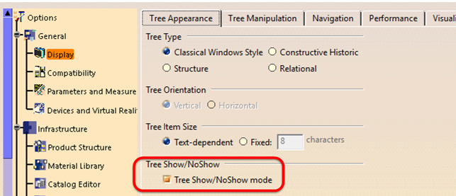

Hey guys,
I've been looking on the net for a few hours now and can't seem to find the right solution to my problem. I'm experiencing a strange issue with CATIA V5 and the Hide/Show command. Whenever I hide/show any feature, it doesn't show up as hidden on my tree. The feature toggles from hidden/shown on the work screen, but not on the tree. This is proving to be quite a nuisance right now, as it's hard to confirm if any small features are showing or not.
Appreciate the help guys!

RE: CATIA V5 Tree Hide/Show Command
Thanks itsmyjob!
I knew about this setting, but for some reason, I was convinced that it controlled the movement of the tree. Thanks for the assistance!
