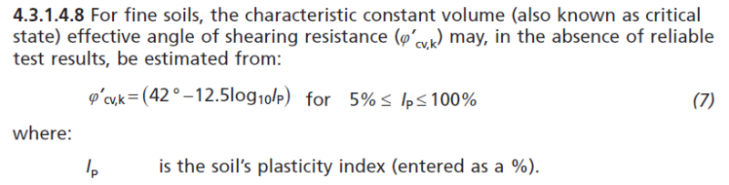

From BS8002 - Code of practice for designing retaining walls. Φ' can be estimated based on Atterberg data.

Okiryi - That second link you posted (Page 18), I am not sure if that is a good reference to use. I checked a PI of 20% which gives a SinΦ=0.5 - Sin (inverse) of 0.5 is a Φ of 30 degrees. I dont think that is reliable? Maybe I am doing it wrong? Am i missing something?
When i check a PI of 20% with the BS8002 equation I posted above it gives a Φ of 26 degrees.

EireChch, here is the L & W chart. It is basically the same to the one shown in the link. Your calc is correct - for LL=20, the phi' is 30.
I think that since the equation from BS8002 is based on critical state soil mechanics, from the stress-strain curve, the strength at constant volume is referred at a point of "lower strengths" (end of the curve) and this may be the reason why the BS equation results in lower phi' values.

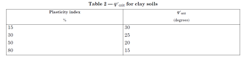

Ive checked it again for a PI of 30%
L & w gives a Φ = 27°
BS8002:2015 (my first equation) gives a Φ = 24°
BS8002:1994 (pic below) gives a Φ = 25°
Not much in it really...
