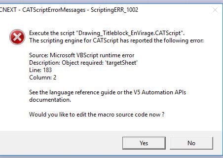

Hi all,
Hoping someone is able to assist here.
I have been provided a macro which populates and re-sizes title blocks to suit different paper sizes. I have pasted the script into C:\Program Files (x86)\Dassault Systemes\B18\intel_a\VBScript\FrameTitleBlock. In Tools>Macro in CATIA, the script is visible.
However, when I access the Frame and Title Block Options in Drafting Mode, the subroutines are not visible. Anyone able to assist?
Catia V5R18 is what I am using at the moment.
Link 1
Link 2
Cheers
Kevin

Ferdo it's not a form on second picture. It is a standard Catia V5 window from where you launch actions.
@ tran.k88 Have you changed original script?

Hi JeniaL,
Original script hasn't been changed. When I try and run the catscript, I get the attached error.
