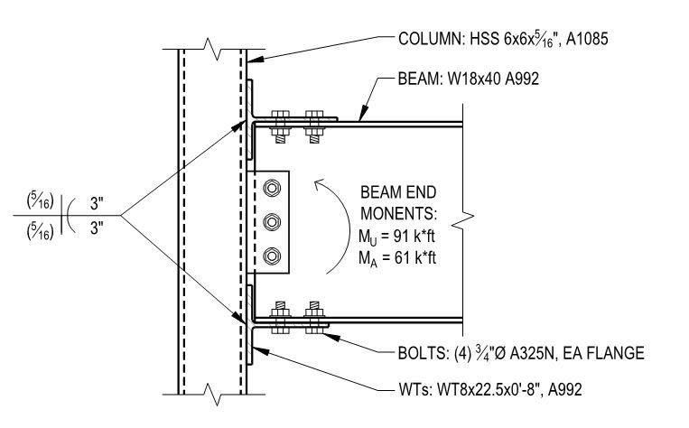

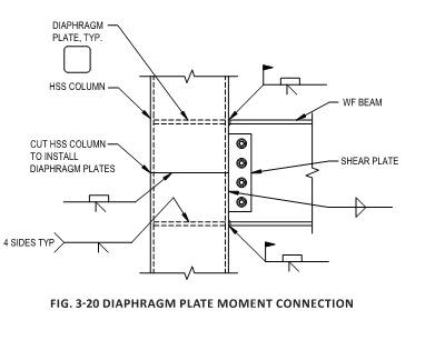

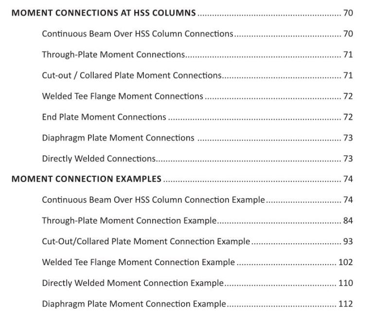

RE: Reviews of STI's HSS Design Manual, Volume 3??

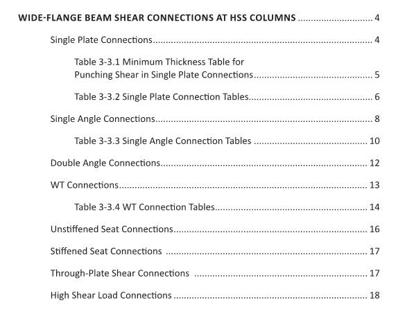

Any chance you could post a similar shot of the TOC for the shear section?

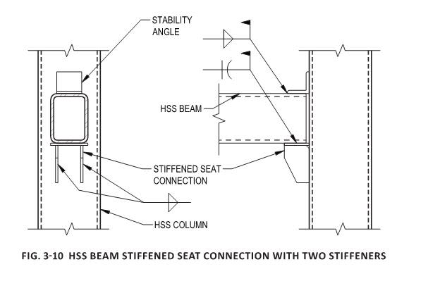

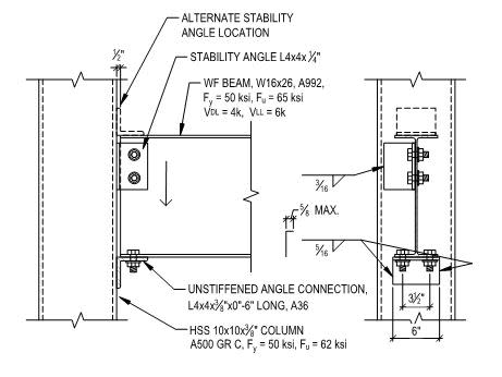

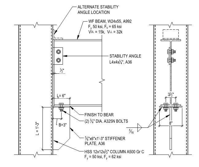

I`ve taken a recent interest in seated connections on HSS columns and wonder if that's addressed here.
