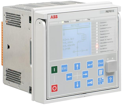

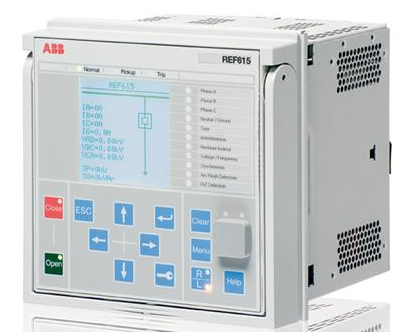

However, from my experience in the ANSI world, red means the breaker is closed and green means the breaker is open. But in the IEC world, red means the breaker is open and green means the breaker is closed.
Here is an ANSI relay
Here is the IEC version of the same relay
