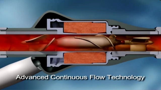

It's for a very small blood pump, about 25mm in diameter. And we estimate about 4000-6000 rpm, so the Reynolds number along the length of the blades are both laminar, turbulent and transitional. The current pumps(LVAD's) have what seems to be a well thought out design, in order to avoid blood damage.
e.g. [img https://image.slidesharecdn.com/vadjosesoto1112f-1...]
That's not the aim of the project at this point though. We want to see if it's possible with a more typical design. We've been looking at NACA 4-series profiles so far, since we can easily get the lift and drag coeffecients for these profiles using XFOIL. And then just using simple 2d velocity diagram to decide the angles. Though I've been reading that due to our hub/tip ratio, we need to look into 3d flow over the blades.

For some small pumps where fluid damage is a risk you will see impellers with very large hubs, the result of this is that there is less difference in flow regime across the blades.
Yes, the profile varies greatly with radial position.
