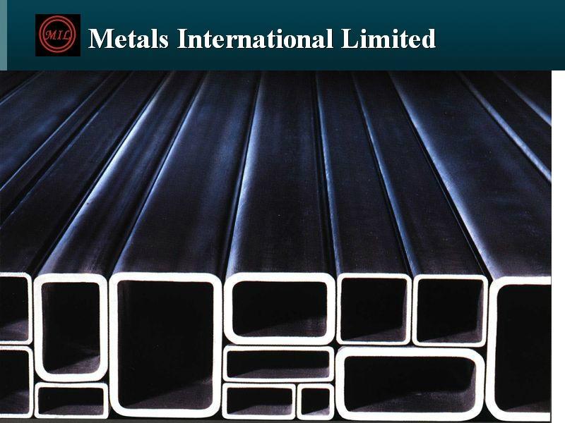

Isn't the inner flat essentially the same dimension as the outer flat? I'd use the outer flat as tabulated by AISC.
RE: Inner workable flat dimensions of an HSS Rect.
This image here gives you kinda a rough idea of the various interior radii at the corners for various thickness. I also typically assume 2t.
