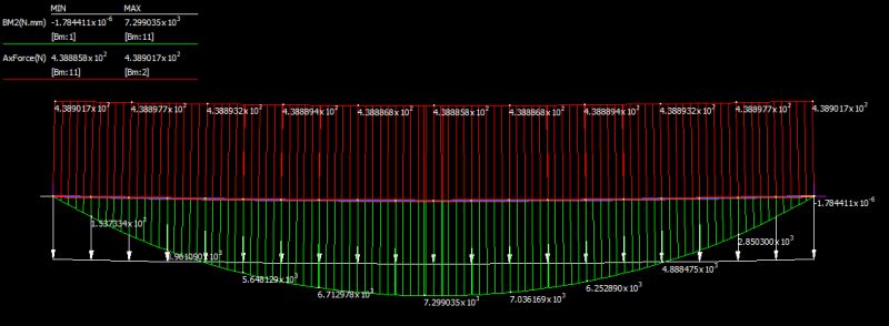

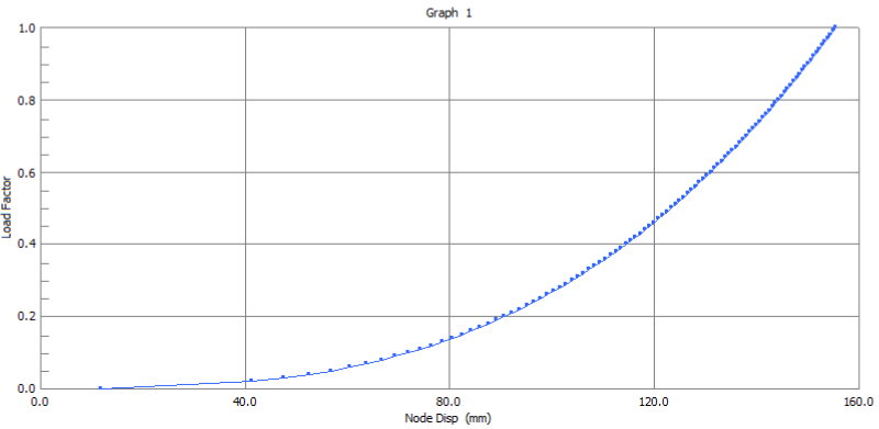

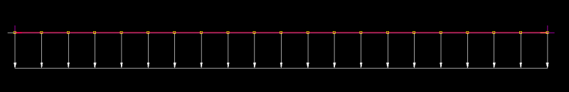

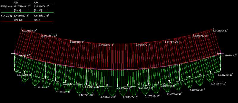

Any (half-decent) finite element analysis program that allows a beam element to resist an axial force and also purports to do a geometrically non-linear analysis should be able to capture this behaviour. The continuous updating of the element stiffness as the beam deflects is central to the idea of geometrically non-linear analysis and this should result in your structure transitioning from resisting loads through bending action to cable action.
Perhaps you haven't subdivided your mesh enough to capture this deformation? Also be careful with load increments, it may not work to apply all the load at once, better convergence will be achieved if you slowly apply the load in small increments.
Here's a quick example in Strand7, in which a slender beam with 20 elements is loaded with a UDL:
Axial force diagram (red) and bending moment diagram (green) with relatively small loading.
Load here is 1000 times higher than the first diagram - bending moment has only increased by a factor of 10 and is now represents a more constant distribution along the length of the beam; primary resistance of load is through axial force.
Load displacement diagram - the stiffening of the structure resulting from cable (membrane) action is apparent.

@JAE: I modeled this in STAAD and it became more of a arching action thing than anything else. I did a beam with moments released and horizontal springs at the end. To initiate the arching action (i.e. axial load), I introduced a bit of imperfection (about 0.5") at mid span and did a P-Delta (the P-Delta didn't have that big of an impact as far as I can tell). The key factor in reducing moment in the beams and getting axial force was the stiffness of the horizontal spring: the stiffer it was the less moment developed and the more axial load there was. This was the case regardless of how much initial imperfection I introduced.
So I guess the question is: are your end supports really stiff enough develop the kind of axial forces you are concerned about?
