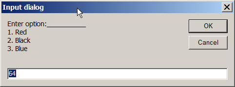

RE: Input box in catia script
Hi, Alan Lowbands
You can ref this sample code
InputBox "Enter option:__________" & vbNewLine & "1. Red" & vbNewLine & "2. Black" & vbNewLine & "3. Blue", "Input dialog", vbInformation
Engjoy guy!
Thanks that’s a massive help.
Really appreciated.
