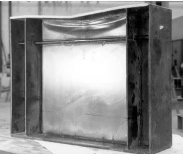

My take:
1) Analytically, you're dealing buckling on a yield line mechanism like that shown below per Deker.
2) For plate girders, the 2 x alpha dimension is 50 tw. That's pretty tall. I don't know if that holds exactly for non-plate girders but the take away, I think, is that you're looking at buckling over a substantial depth. Probably almost the entire beam depth in a lot of cases.
3) Anything that interrupts the buckling mechanism shown below is going to help some. Anything.
4) I don't know that it is necessary to start the stiffener reinforcing from the very bottom of the web. The purpose of the stiffener, for this one failure mode, is not load delivery but, rather, out of plane web bracing. A stiffener doesn't necessarily need to bottom out to get that done in my opinion.
5) In my opinion, a pair of angles tightly bolted and spanning most of the beam depth almost certainly disrupts the buckling pattern that is web crippling. Of course, to make that argument, you have to go off reservation a bit which requires some risk tolerance and a willingness to expend effort that may not be commensurate with your fee.
6) One alternate reinforcing scheme that would involve less head scratching would be to place half height vertical stiffeners either side of the secondary beams. I don't know your exact proportions but I have a hard time envisioning a practical arrangement for which that would not work.
7) A second alternate reinforcing scheme, space permitting, would involve the use of longitudinal stiffeners to disrupt the presumed buckling pattern. Some googling will turn up some papers on that. Medium head scratching.

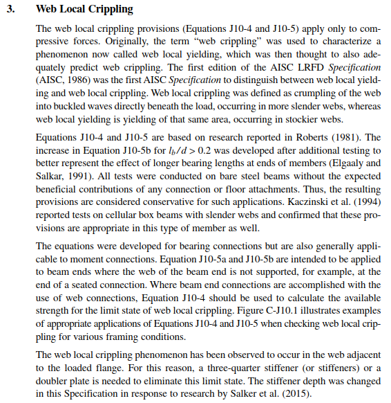

@BA here is the AISC equation for Web Crippling (which includes d (depth of girder):
Interesting to note that the 2016 Manual states that the stiffener must be 3/4 depth whereas the 2010 only required half-depth.

Here is the commentary:

RE: Perpendicular Beam to Brace Against Web Crippling
Thanks for the failure mode picture KootK. I understand web crippling much better now!
Looking at that makes me question why bf isn't included in the equation. And I still don't understand why d is in the equation. Except to possibly be used as an upper-bound on the two alpha parameter, it doesn't seem to come in to play at all.

You're very welcome cal91.
Quote (cal91)
Interesting point. Maybe it's only a part of the flange near the web that really participates so more based on tf/tw ratio? Just guessing/intuiting.

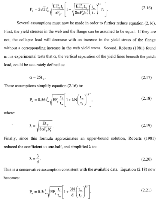

Hokie93 - Thanks for the reference. I wasn't able to track down a free version of the Roberts paper, but he did author the chapter of the book I linked to above which contained the web crippling derivations.
KootK - Great references, thanks for sharing. The longitudinal stiffeners in the Elgaaly and Salkar tests actually were placed near the top flange (loaded flange) at distance of 0.2d, while the crippling occurred within a height of 0.16d. But your point stands, and I agree that a well-placed longitudinal stiffener (25tw from the loaded flange?) would have to increase the crippling capacity. Also agree that for OP's condition the two vertical stiffeners alone seem the most practical. I thought this bit from your second reference was interesting on how bf was removed and d was inserted into the crippling equations:

Quote (Deker)
That is interesting. And it answers Cal91's question I believe. I can't claim to actually grasp the physical significance though, I'm afraid.
