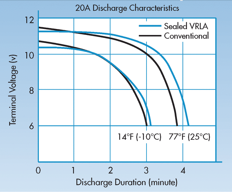

I've been doing some reading on Peukert's exponent but I'm still confused. I'm familiar with sizing a battery bank based on the system load, but in my current application, I want to make sure that at the end of 24 hours, the batteries are lower than "X" volts. My reason for this is that components in the field have a minimum operating voltage (18 volts) and when I do the voltage drop calculations, I'm ending up with 8 AWG wire with is too large for the device screw terminals, and expensive to buy and install.
The voltage drop is based on a starting volt of 20.4, with is 85% of the power supplies rating. The assumption is that if the system looses AC power, I'll be running on batteries and should assume a voltage loss after 24 hours on batteries, down to 85% of the system rating (i.e. 20.4 volts).
If I can demonstrate the math to show a final voltage of say 23 volts (or something close), I can use a higher starting voltage for my voltage drop calculations thereby decreasing my wire size.

You have two separate problems:
> You need to have a voltage vs. SoC (capacity) curve to figure out how much you can afford to discharge. Your math is not right, because 20.4V does not mean that you're at 85% of capacity
> You need to have discharge curves, and/or Peukert exponent information to determine how much of the raw capacity you're actually going to consume.
