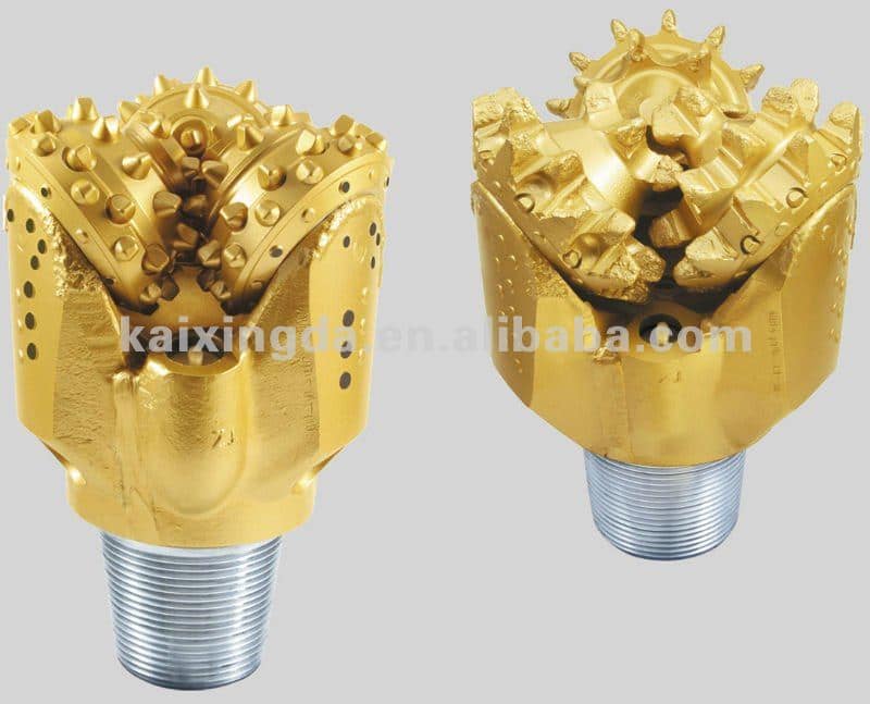

for a larger diameter hole (oversized to fit the 4' diameter cmp as suggested by slide rule) drilled through schist/gneiss, than wouldn't they use a reverse circulation) rock bit, not a core drill? seems like a fair amount of vibration from that next to the subway. something like this?
Good point. Although I have put in piles of that size into bedrock and heard no complaints about vibration. But it never hurts to ask contractors about what they plan to use.
On the other hand it's a point for micropiles: I've asked those contractors a bunch of times if it will produce any appreciable vibration. They all say no. (Some of them will even put it in the contract upon request.)
