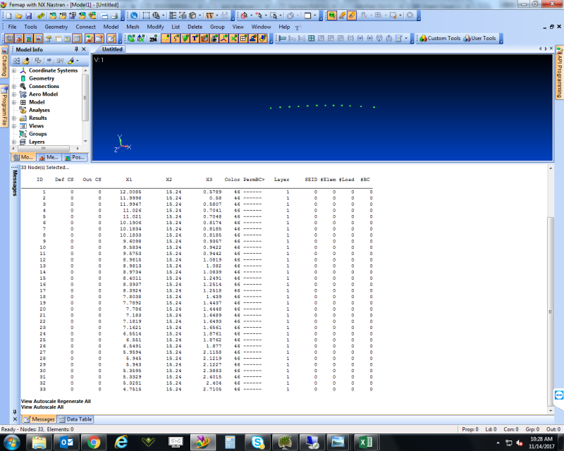

export points into femap from excels via macro
3
RE: export points into femap from excels via macro
You have the “.Put” method graysd out. You’ll need that to actually create the nodes.
You may also want to include “.feViewRegenerate(0)” at the end to redraw the screen.
With those small changes your script created nodes for me.
Hello Rcatania, thanks for the suggestion - it worked. i wish the coordinates to be exported as points, not as nodes. how do i achieve that ..thanks

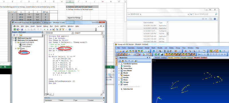

You will need a point object instead of a node object. In your script from "Dim nd as node" down to "loop" should be changed to
Dim pt As Point
Set pt = App.fePoint
I = 5
Do While Cells(I, 2) <>""
rc = pt.Get(pt.ID)
pt.ID = Cells(I, 2)
pt.x = Cells(I, 3)
pt.y = Cells(I, 4)
pt.z = Cells(I, 5)
pt.defCSys = Cells(I, 6)
rc = pt.Put(pt.ID)
I = I + 1
Loop
The nd.OutCsys is no longer needed.
You need to change your code for Module2. Also, you need to dimension point a little differently. "Dim pt as femap.Point"
thanks all, solved
