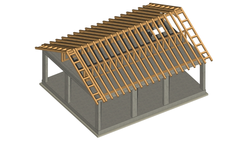

This is the structure I am trying to model
RE: Modelling of OSB panels
I would advise against it. Design the roof and RC structure separately. You are wasting time with so much modelling. Use this time to properly design the details - connections - instead.
Ends of roof seem unstable - last rafter has no support at the bottom.
What is your ridge beam doing - purpose?
Put OSB sheathing on top of rafters, design two shear walls for seismic/wind, design "triangle" with two rafters, two columns and two supports for vertical and horizontal forces, apply all loads to RC structure and carry on. Simple if you don't want to complicate.

Quote (molibden)
There will be a 25cm thick gable wall at both ends of the roof, build on top of the RC slab.
The two rafters at each edge of the roof will be directly fixed/anchored to the 25cm thick gable masonry wall.
The gable ladder will also be embedded within the masonry wall. I will also use steel brackets to connect the gable wall to the roof structure.

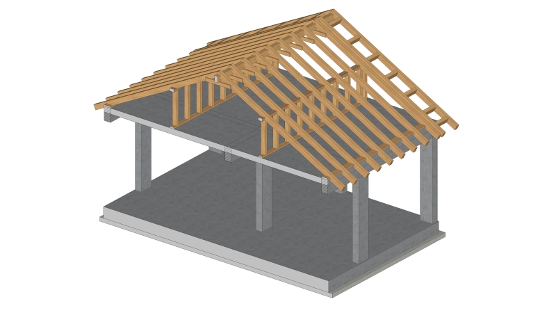

Quote (molibden)
The ridge beam is there for constructibility purposes, bracing and completeness of the roof,
as you can see the rafters are supported by the RC slab at one end and by the stud wall in the middle, the rest of the rafter is then left to cantilever at ridge level.
