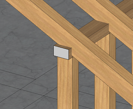

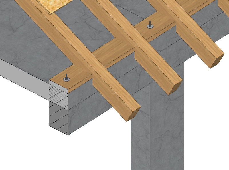

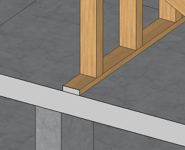

I am now modelling the timber roof frame for the analysis and design and i need your advice on what supports/type of joints shall i use between the members.
In total there are 4 different connections that i need to model
1) Rafter to wall plate
2) Rafter to stud wall
3) Rafter to ridge beam at the top
4( Stud wall to concrete slab

1. Rafter to wall plate: There should be a sill board (2x) above the concrete attached similar to item 4. The rafter gets notched around it. Also, the overhangs get squared off.
2. Rafter to stud wall: Do not notch. Use simpson connector or 2x stub.
3. Rafter to ridge beam: cut rafters vertical. ridge beam is continuous.
4. Stud wall to slab: Expansion/wedge/mechanical anchors or concrete screws.
Wood rafter roofs are very common. It might be best to put vague notes for code compliance.

Thanks a lot for your reply, taking your advice into consideration these are the connections I have.
What about the joints in the analytical model?
1. Rafter to wall plate -> birdsmouth cut on rafter connected to wall plate with screws and L-shaped brackets on both sides
What joint shall I use for the analytical model? PINNED or FIXED or what releases shall i apply?
2. Rafter to stud wall -> birdsmouth cut on rafter or SIMPSON VPA connector without the cut
3. Rafter to ridge beam -> cut rafters vertical, connect to ridge beam with screws. ridge beam is continuous.
4. Stud wall to slab -> Connect to RC slab with SIMPSON anchoring bolts

For the analysis side of things. All pins. Generating fixity in wood-wood connections requires tight detailing and lots of fasteners. That is not generally required for structures like these.
Also as mentioned in the previous thread, your birdsmouth cut at the bottom of your rafters seems excessive. As dik noted, it's typically limited to 1/3 of the member depth.

RE: Modelling of a Timber Roof
My comment for item 2 was misinterpreted. Do not cut a birdsmouth. That is a notch at a neg moment high point.
The top plate can be at roof slope, studs extend to rafter with blocking, or metal connector. There are lots of options.
Quote (RPMG)
Yes of course you are right, we do not want to weaken the rafter at that specific point, as you said that is where the max bending moment is expected.
Therefore my options for the Rafter to Stud wall connection are:
1) use 2x top plates on the stud wall and bevel the top plate at the roof angle for the rafter to sit on WITHOUT a birdsmouth cut
or
2) use a SIMPSON VPA connector as shown below
